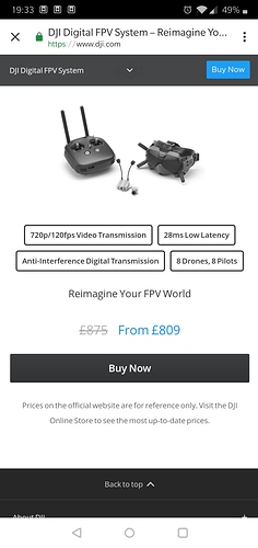

28ms latency and a 4km range…
Details: DJI Digital FPV System - DJI
Oh, and try not to laugh at the price
Price isn’t that unreasonable tbh…
My goggles and module are near £600. Radio transmitter another 150ish
So not far off

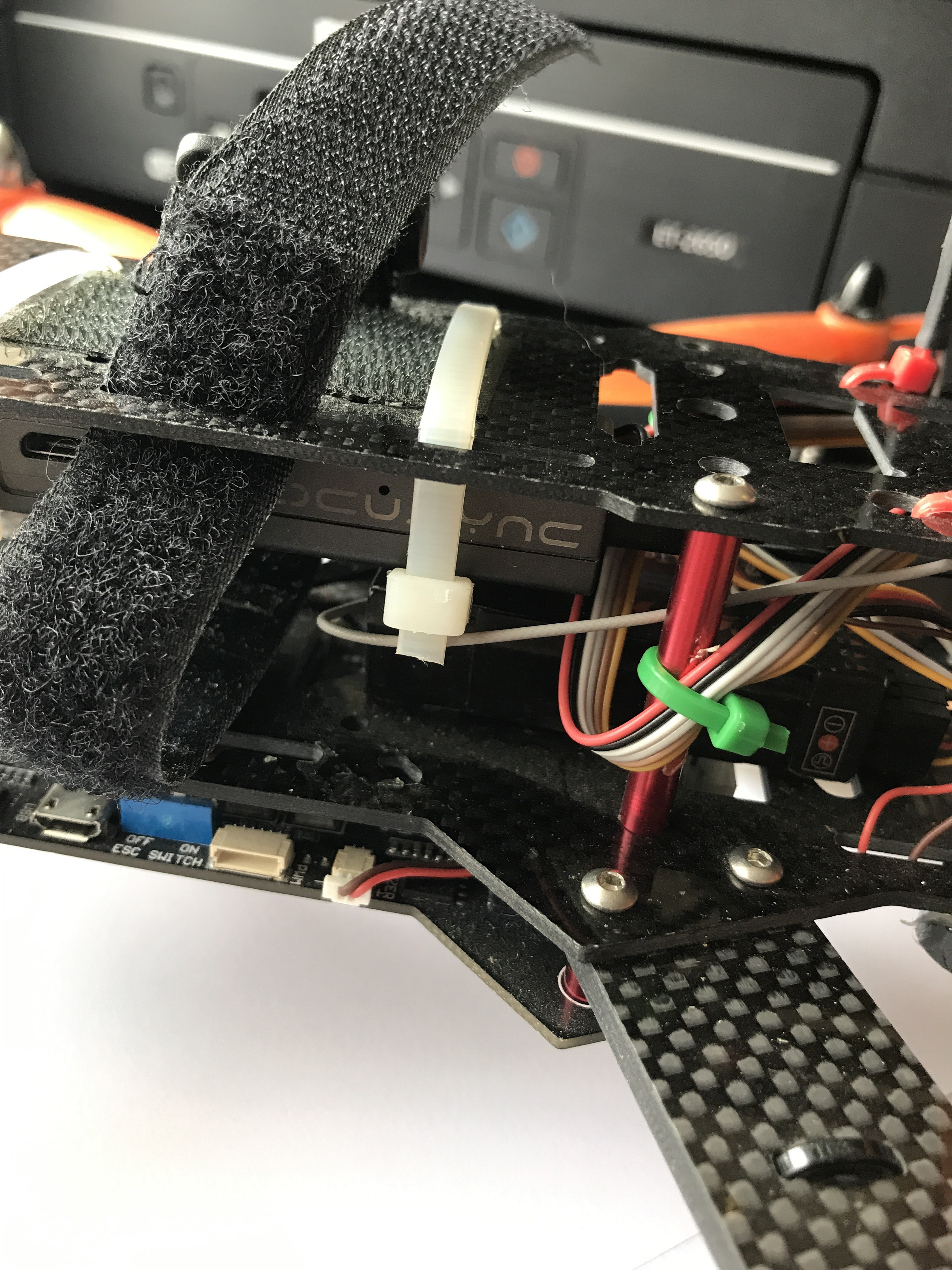

I wonder if it the same kit I bought 2 years ago from DJI which I haven’t flown in anger for all this time.
This kit only works with the RE goggles, you also have to piggy back an RX to it and in my example a Frsky D8R.
It gets bloody hot, this new one is 720p, mine is 960p. Once again DJI are out to milk the hobbyists by way of yet another dedicated TX and system, I like the goggles though they remind me of “Ant Man”. If these goggles worked with the Mavic and Inspire I’d get them.

Ok should have known! What IS the price for this?
It’s actually not a bad price for the full system if it works well.
