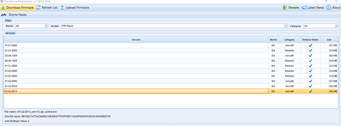

You can access a FW archive from within the desktop APP, or alternatively go directly to the website linked in the APP and download the firmware locally.

Using the drone-hacks app, I was unable to re-flash my FPV drone from 01.02.0000 to 01.02.0000.
The app said the anti-rollback prevented me (?)

At the time my current FW was 01.02.0000 and I tried re-flashing 01.02.0000. But that didn’t work via the Drone-Hacks Windows app. Hence why, I then “upgraded to 01.02.0015” … to then downgrade again.
