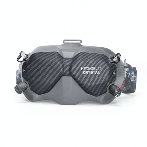

If you’re not planning using the goggles with the DJI FPV Drone then its definitely worth upgrading the goggle antennas to 5.8 only antennas. The TrueRC stubby’s have good reviews. Patch antennas are good for straight out in front of you.

If you use the power hack to take it up to 700mW you are only taking it to the level which is standard in the US & Canada, so I would expect any equipment sold in those markets to be able to handle the heat.
Note that the next step up in the goggles config menu from 25mW is 200mW if using FCC settings ![]()
Cheers mate I think 200 would be fine but not sure which country code to use ???.
1 works well
Gives the option of up to 700mW, and 8 channels ( though for some reason, after the initial startup, mine only offer 7
