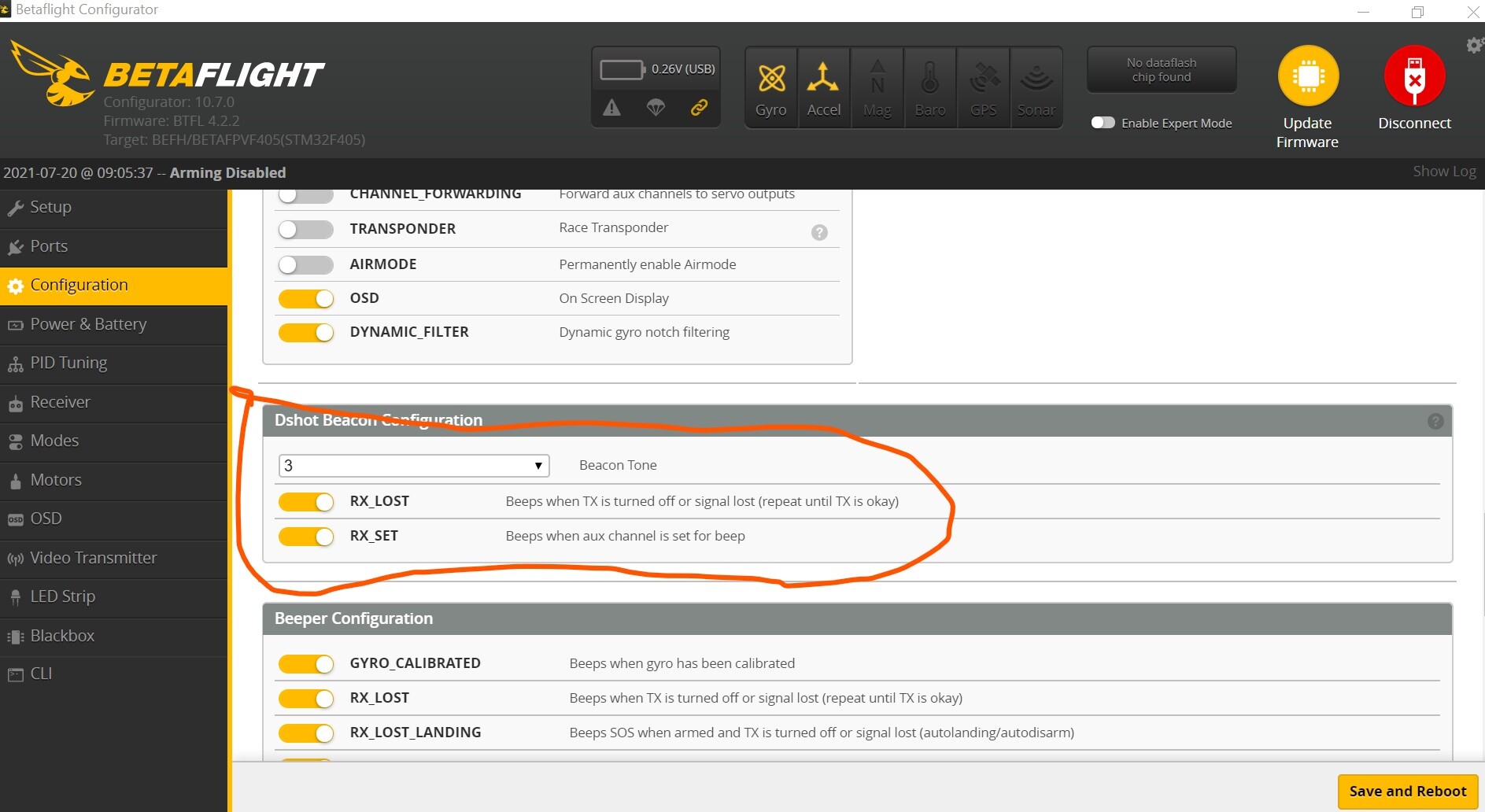

Im still missing my OSD and bleeper on my BetaFPV
if you find anything out please give us a shout ![]()
Will do
Nic, you’re running DSHOT so in BF configurator you should be able to enable ‘DSHOT BUZZING SOUND’
Not sure what it’s really called and where to find it,
I’ll look later but with anyluck @DeanoG60 will know and save me a job ![]()
Config tab:
DShot Beacon Configuration.
And make sure you have the beeper mode setup in the modes tab.
Select add range to the beeper leave it set to auto and flick the switch to select the correct AUX channel.
(You’ll need the quad powered up with a battery and your controller turned on)
Think im on a winner tonight
as I think iv sorted my beacon out also.
I have to hook it up to blheli …
Yeah scrap that its still not working ![]()
Follow the above. It’s more than likely not configured to your switch.
all sorted mate was not switched on in configuration
