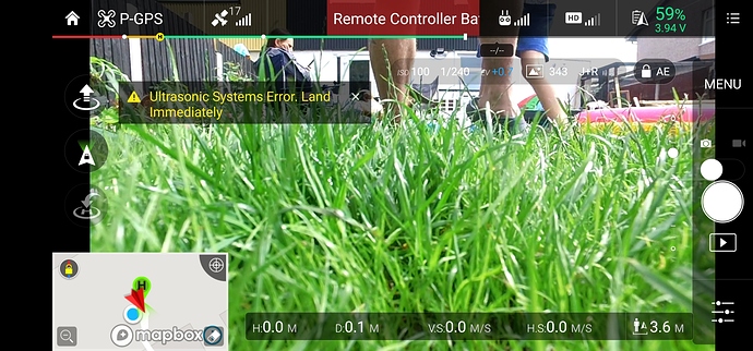

I have just tested the inspire for the first time since I had the above issues. Upon take of i get a message saying ultrasonic systems error land immediately

What happens if you simply turn off the VPS in your app? Do you still get the errors?
Thanks, I will try switching it off tomorrow.

I tested the inspire today only low level (3-4m) as I left the charged batteries at home
it did not show the error message again but it seemed to wonder slightly and I was adjusting its position instead of it being fixed in one position. Is there a way of calabrating the VPS. I did a sensor calabration last night not sure if this includes vps.
I haven’t had the need to calibrate the VPS myself but I’ve found a DJI video on doing it for the P4 which has a similar system How to Calibrate the Vision Positioning System on DJI Phantom 4 - YouTube
While you are at it I’d give both the IMU and the compass a workout.
Calibrating IMU: https://www.premiumbeat.com/blog/how-to-calibrate-the-dji-inspire-1-drone/ Also covers compass calibration - which you do religiously before every flight, right?
Iv just watched this vid thanks I will do this tomorrow hopefully.
I calabrated the IMU last night this is done through the app of I’m not mistaken.
I tried this today and either I am missing something or there Is no assistant software for the inspire 1. The one I downloaded didn’t recognise it when I plugged it in.
My bad, That article was from 2015 and was using DJI Pilot software which has been superceded by DJI GO. Here is a very bored sounding American telling you how to use the current software:
