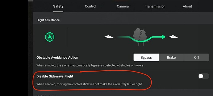

IIRC there’s a setting in the Fly app where sideways movement can be disabled - worth checking it hasn’t been set
Don’t suppose the flight safety mode has been switched on in error?
I found exactly the same after the last firmware update and the ‘Disable sideways flight’ mode had defaulted to on.
Must admit I did panic at first when it happened.
Thanks all - your suggestions helped very much in correcting the problem.
It seems the last update as suggested above disabled the sideways movement.
