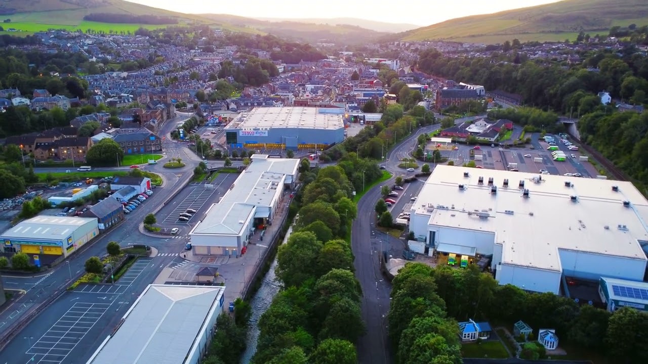

I found some old time lapse photos i done a while ago. But since using Dji media maker for my previous time lapse i thought i would try it, and i am very happy with the result. It is taken in Galashiels, currie road. I took 562 photos to make it
