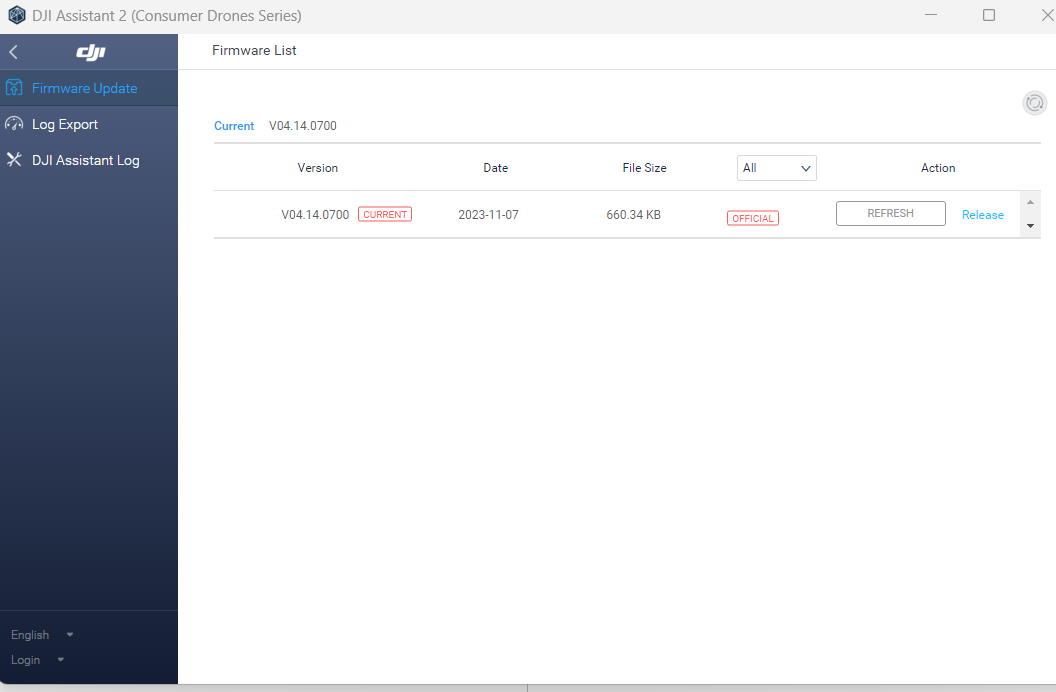

Take a screen shot of it connected to the assistant

Sparkyws was from dji Assistant consumer drone series. Here is screen of controller which is always there
Also screen shot of dji assistant

Do you know what version of fly app is installed ?
Have you clicked the refresh firmware button, and removed any SD cards
Yes clicked refresh button and no sd card in controller. Still the same
When refresh is complete blue light comes on for few seconds then goes red
