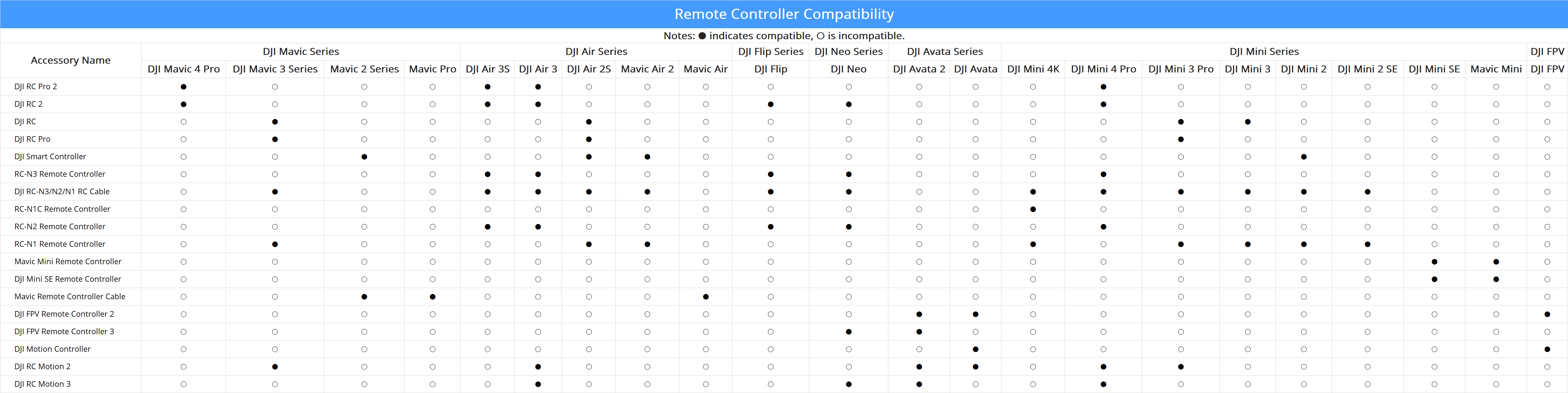

Hi, thank you for the info, watching the you tube videos as i type lol, i took the plung and ordered the neo fly more combo so gotta start learning now, i do have a mini 4k pro already and have the rc2 controller, can it be used same as the fpv remote controller 3, ???
As far as I’m aware, you cannot pilot the Neo in manual mode with the RC2. You would be limited to flying in ā€œnormalā€ and ā€œsportā€ modes. You will need the DJI FPV Remote Controller 3 (in conjunction with the Goggles (N)3) to fly in manual mode.

It will just behave like your Mini 4k with the RC2.
Not as fast and not as agile as the the FPV remote (which is for manual flight)
