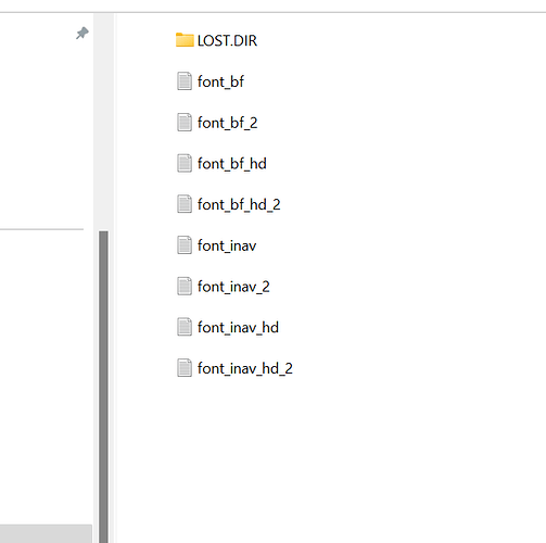

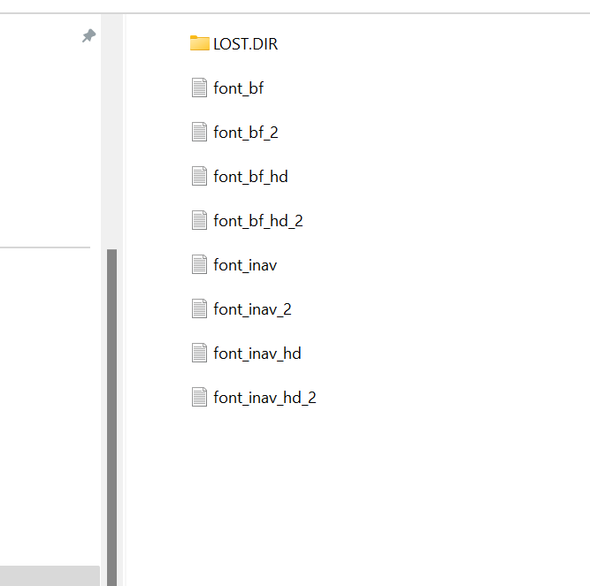

I know this is and old thread, but I really struggling loading WTFOS fonts on to my V2 goggles via Sd card. Iv had them on there before but made the school boy error of formatting the sd card ![]()
Iv tried a number of differant ones with no joy, what makes it annoying is everyone says how easy it is, clearly not. I just have a coulpe of questions, does it have to be 4 files as iv downloaded a few fonts that are only 2 ??.

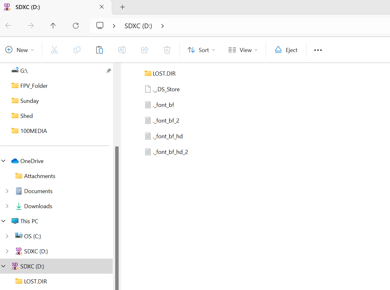

Not sure if it makes a differance but my card only has 1 file in the root ?? Iv tried formatting the card in my goggles as I noticed it say No Sd card in the top left handside, cant remember seeing this before???.

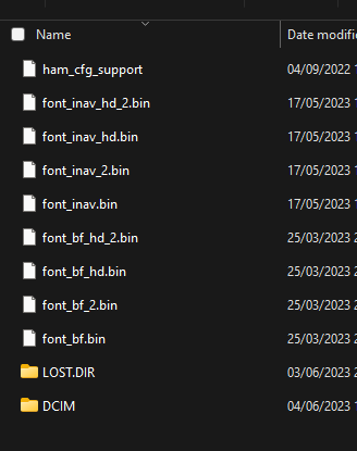

Your font names are wrong:

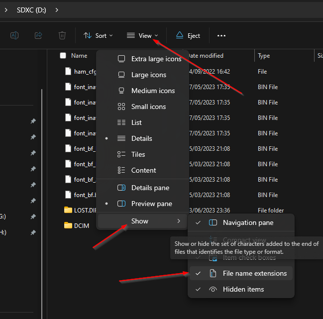

You’ve probably got the extensions hidden BTW, so don’t add .bin, as they’ll be .bin.bin (display your extensions too)
