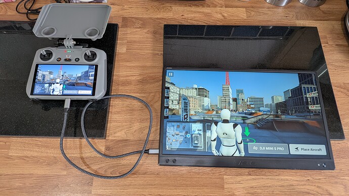

On a side note, I thought I would try plugging in a USB-C cable between the RC2 and one of my USB-C monitors, and it works a dream.

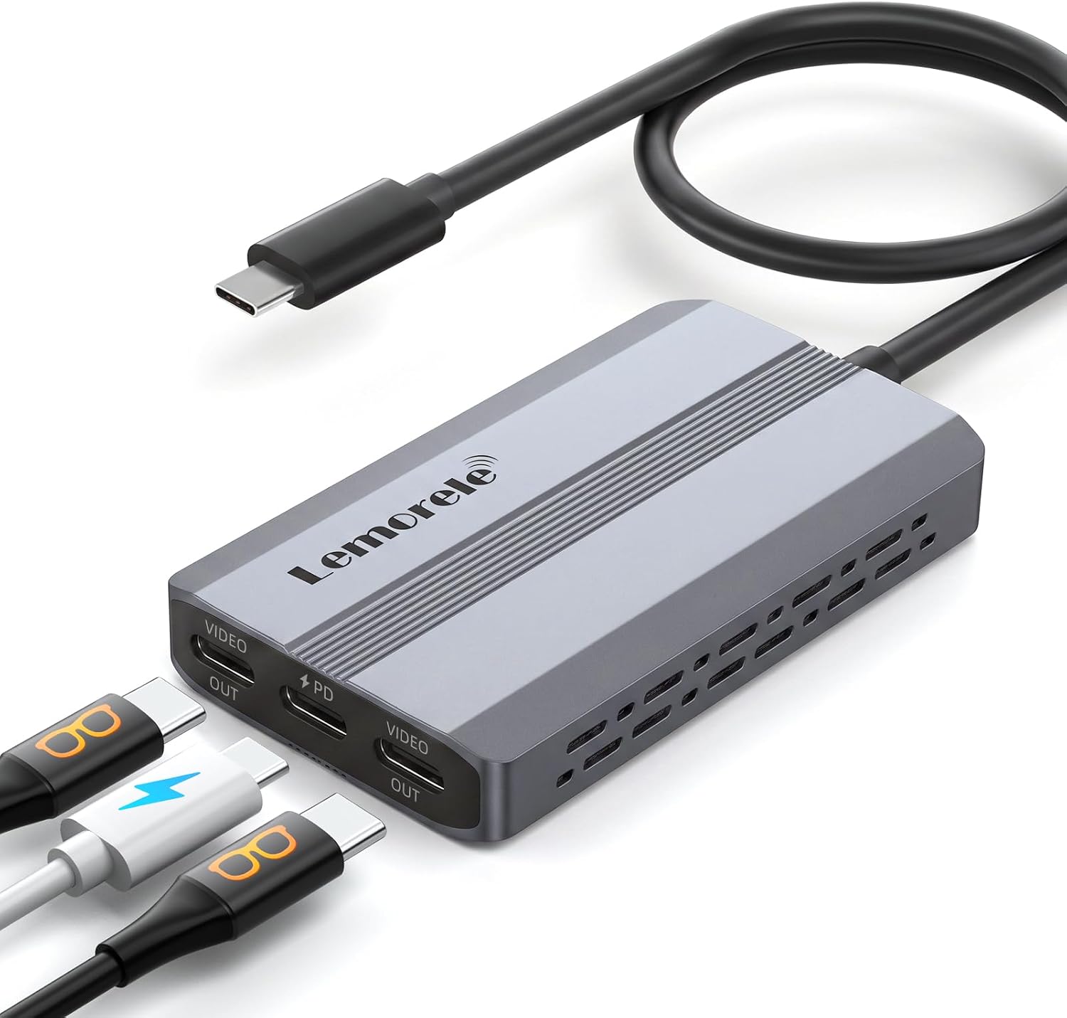

This was the item I got, but does not work as I hoped.
“# Lemorele USB-C Video Splitter, Dual USB-C Output 4K@60Hz, 100W PD
Compatible with Steam Deck, Switch 1 and Switch 2, Supports AR Glasses & Portable Monitors, Mac Only Mirror Mode”
So I have DJI RC-N3 → google Pixel (with DP) → Lemorele USB-C Video Splitter(powered by PD), → External portable USB-C monitor that runs on USB-C power.
When I connect it up monitor switches off and DJI-app complains no connection to Controller.
Thanks for your thoughts, it’s an interesting nut to crack !

Forgot to post link. But rem I cannot get this to work as planned:
