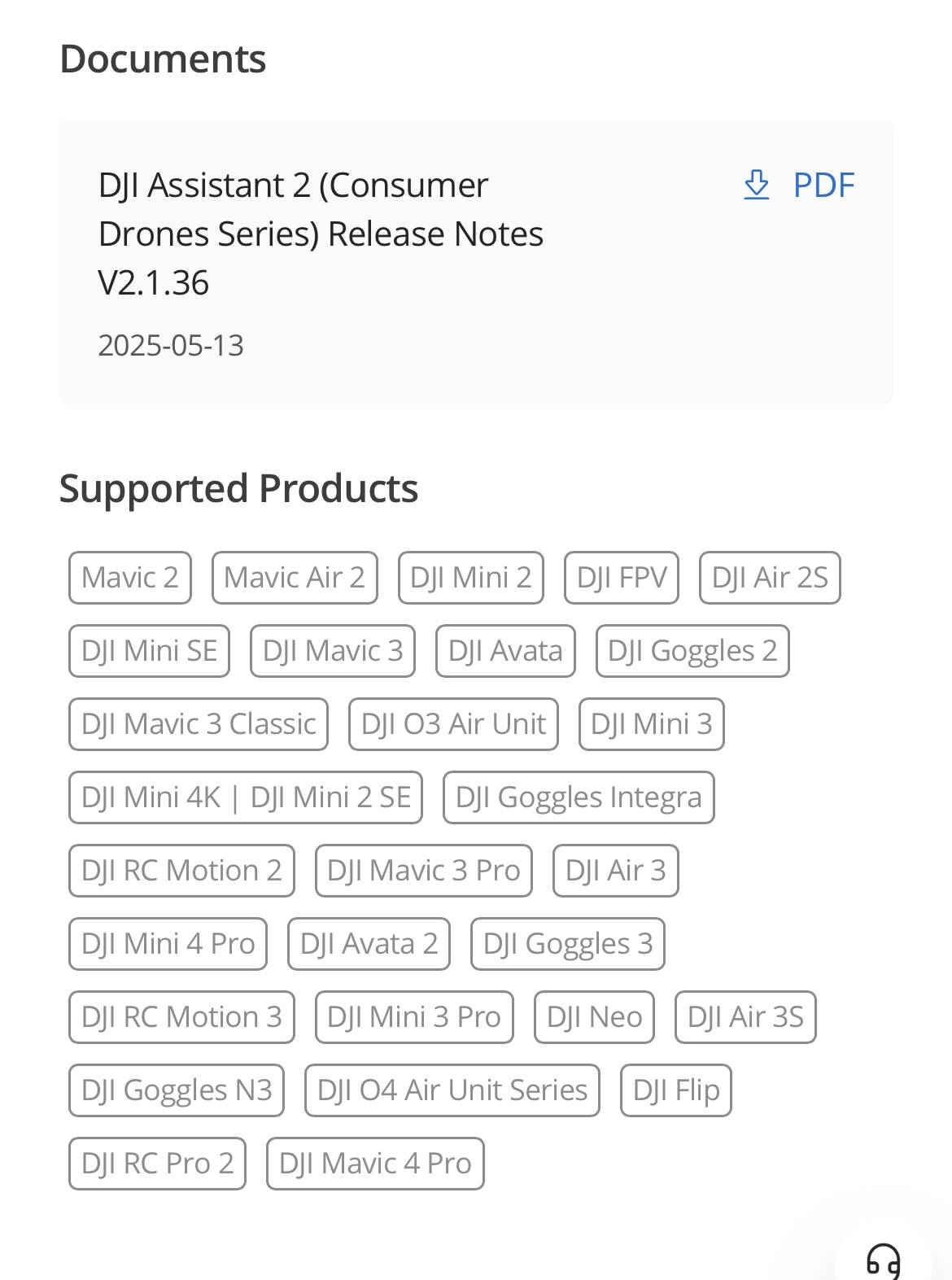

Well, moving forward plugged it into DJI assistant 2 for consumer drones but it’s a version from last year, so went hunting for the later version thinking it might be that ( that’s stopping it from flashing ) but I couldn’t even find DJI assistant 2 consumer drones that ( lists ) the rc pro rm510 a later version & can’t even find the old one either :thinking:

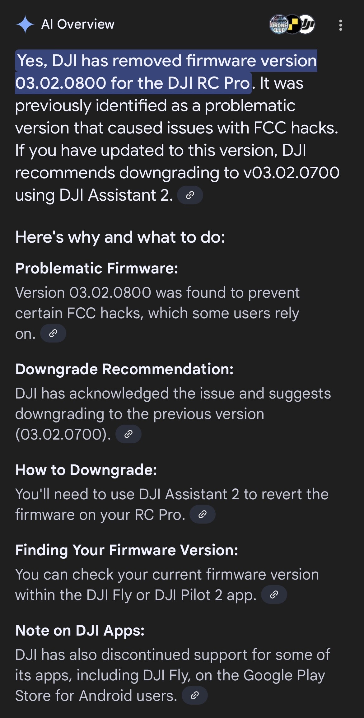

Anyway thought I’ll type in google to see if DJI have removed that version from there servers & this is what Google said, if only I had checked earlier on but did not as I thought what’s the chances hey ! :person_facepalming:t2:
However moving on from that as I now know regarding the FW, where the hell has the Rc Pro Rm 510 assistant gone the latest is below or am I missing something, thought I’d share anyways .

What I do find hard to believe tho but then again what do I know is that DJI I have pulled that version because people rely on patching their FW , hmmmm strange.
