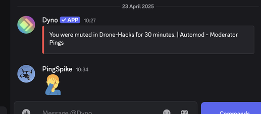

@toke I tried to msg you earlier to tell you the SSL cert was knackered on your blog site.
Yea pat did mention it. He’s closed the blog but hasn’t removed the link on the site :slight_smile:
(He forgot and took busy doing other stuff)
No worries :slight_smile:
Great work on the RC Pro vs Fly app mod :person_bowing:
