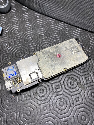

Lovely sunny day today so I decided to take my Spark out for a spin.
Powered up all connected fine but about a minute or so later I saw green & red bars on my screen then the error message about image transmission error, forward vision error etc…
Searched Google, saw a few people suggesting restore to factory & sd card format.
I tried the later in the drone but it was not recognising my sd was even inserted.
Saw another suggestion that perhaps the cable cable had become loose, they had crashed there, I hadn’t, my last flight with this drone was Aug last year and ended without issue.
I decided it was easy enough to check for a loose cable and proceeded to open up the drone, that is when the £&@# words started.
Nearly everything inside the drone was corroded, the heatsink under the GPS module looks like flaky cardboard.
I have never flown this drone near water and never fly in bad weather.
The corrosion is worse near the rear of the drone and it is stored in its bag bottom down, so I wonder if this is internal condensation after flight condensing on the RF cans and then running down, who knows.
I purchased the Spark second hand in Feb last year and flew it numerous times without issue until now albeit with a break since last Aug.
I priced parts on AE for £80 but currently looking at other second hand Sparks on eBay.
Thing is although this drone doesn’t get flown a lot, it’s really good fun to fly and quite cute so I don’t want to bin it.
The drone itself is clear of any signs of corrosion, weird.

What, the same issue as mine with corrosion?
Did it originally come from a seaside area? The salt in the air (especially being forced through for cooling) would do that to electronics.
My heatsink is completely shot, managed to find just that part on eBay for less than £9.
Just ran the main board and GPS module through ultrasonic bath with IPA a couple of times, now in dehydrator to fully dry.
Not sure about the GPS module, after taking it out of IPA bath I noticed what looks like a very tiny coin cell on the board so I’ve probably shorted that :smirk:
If I can get image back and sd card read it’ll be a great step.
Unsure mate just that it shorted out and went up in smoke so something got wet me thinks

I put everything back together enough just to test it, and still the same fault.
Forward vision sensor error and no image.
When I unhook the forward IR module completely there are loads more errors including compass etc…
I am just assuming that forward vision is the IR unit itself so have ordered a replacement, cheap enough to try it.
Odd how if it is just the IR board, it knocks out image transmission too.

A quick update.
I received a replacement front sensor, heat sink & gps unit and fitted them, still the same error.
I sort of guessed that, even though the error says front vision sensor, the sensor itself looked free of any corrosion.
I’m thinking that it’s a damaged trace on the PCB to the cpu and that is all under the cans which at this time I do not want to remove but I may do this in the future just for kicks :joy:
My next option was a replacement main board, I looked into this but then spotted an opened and not used Spark open to offers on eBay.
I got a great deal on a whole drone and so went down that route.
New one was spotless had no miles on it and needed activation as well as usual calibration for a new drone.
Glad to have a working Spark back in my fleet.
