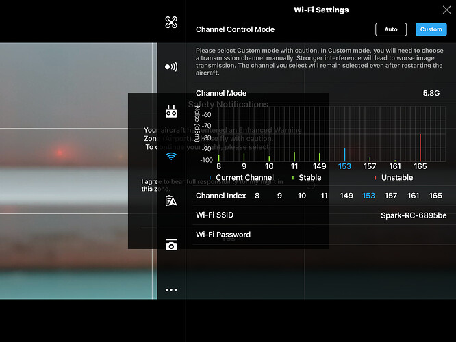

I tried with the cable and the wifi and Bluetooth off and it was the same then I change the Chanel following the video and it it went up to 450m. I only seem to have 5.8 GHZ on my app how can I change to 2.4 I have attached a couple of images. Thank you again image|690x318
I think you will find that you can scroll the channel graph left and right.
EU 2.4GHz channels are numbered 1 to 13.
The 5.8GHz channels run from CH32 to CH165, with some significant gaps.

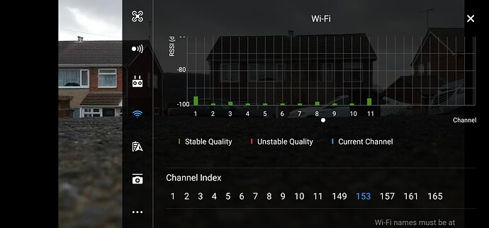

It looks like there’s been a few changes to the APP since I last used my Spark.
I’ve just fired everything up to check that everything I said above was actually true and… I need to revise a few basic principles.
For reference this is the screen grap from my Android Phone (Huawei P30).
As you can see my Channel Activity graph above covers the available 2.4GHz channels, in my case 1 through 11 as I’m in FCC mode.
Below this is the channel selection, 2.4GHz, 1 through 11, and the five 5.8GHz channels (149, 153, 157, 161, and 165). My Spark to controller link is currently on Ch153 as indicated in Blue.
I think as DJI is as DJI does is they’ve failed to enable 5.8GHz on the activity graph for this version of the APP as there should be a big blue line for channel 153 indicating the assignment of my controller.
I’ll see if I have another Android device lying around running an older version just to confirm this later.
Nidge.

Below is a screenshot from my iPad. As you can see on the channel activity graph we have both 2.4GHz and 5.8GHz activity options showing. I will admit this is quite an old version of DJIGO4 so I can’t confirm or deny they screwed up the most recent iOS version in the same way.
