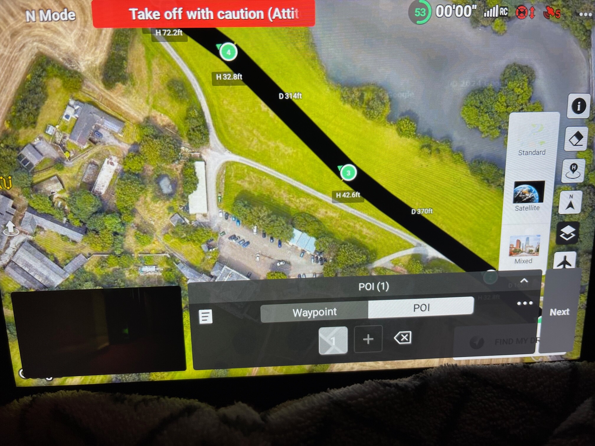

I’m trying to plan a remote flyover of a golf hole using Waypoints.
Problem is my route line is almost the width of the fairway (!!) and is jet black - not thin and green like on all the Youtube tutorials. See pic attached.
Anyone know what the issue is please?
I’m using a Tripltek 9 to input.
Thanks
Just reading a short article on a DJI forum on the same issue, there was no real resolution but does your tablet have dark mode ? Check to make sure it’s not switched on if it has one, also have you tried changing the standard / satellite & mixed map modes to see if that changes anything this bit just an educated guess,
Lastly on the article I just read are the lines black when the mission is running ?

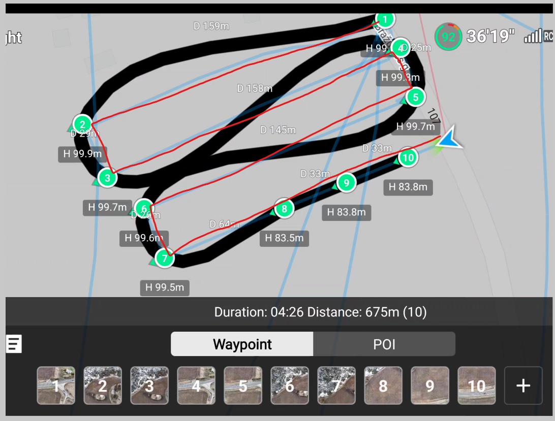

I did just find on another DJI forum which was about the mavic 3 but slightly off topic he to had black lines picture below,
Yes maybe as you say,

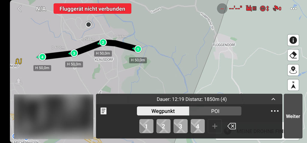

I have found a bug in the waypoint flight part of the Fly app. It doesn’t affect the flight, but the actual black flight lines lines randomly move on the screen. Never change position in flight and even though the line has moved the M3 still navigates between waypoints correctly using straight lines
