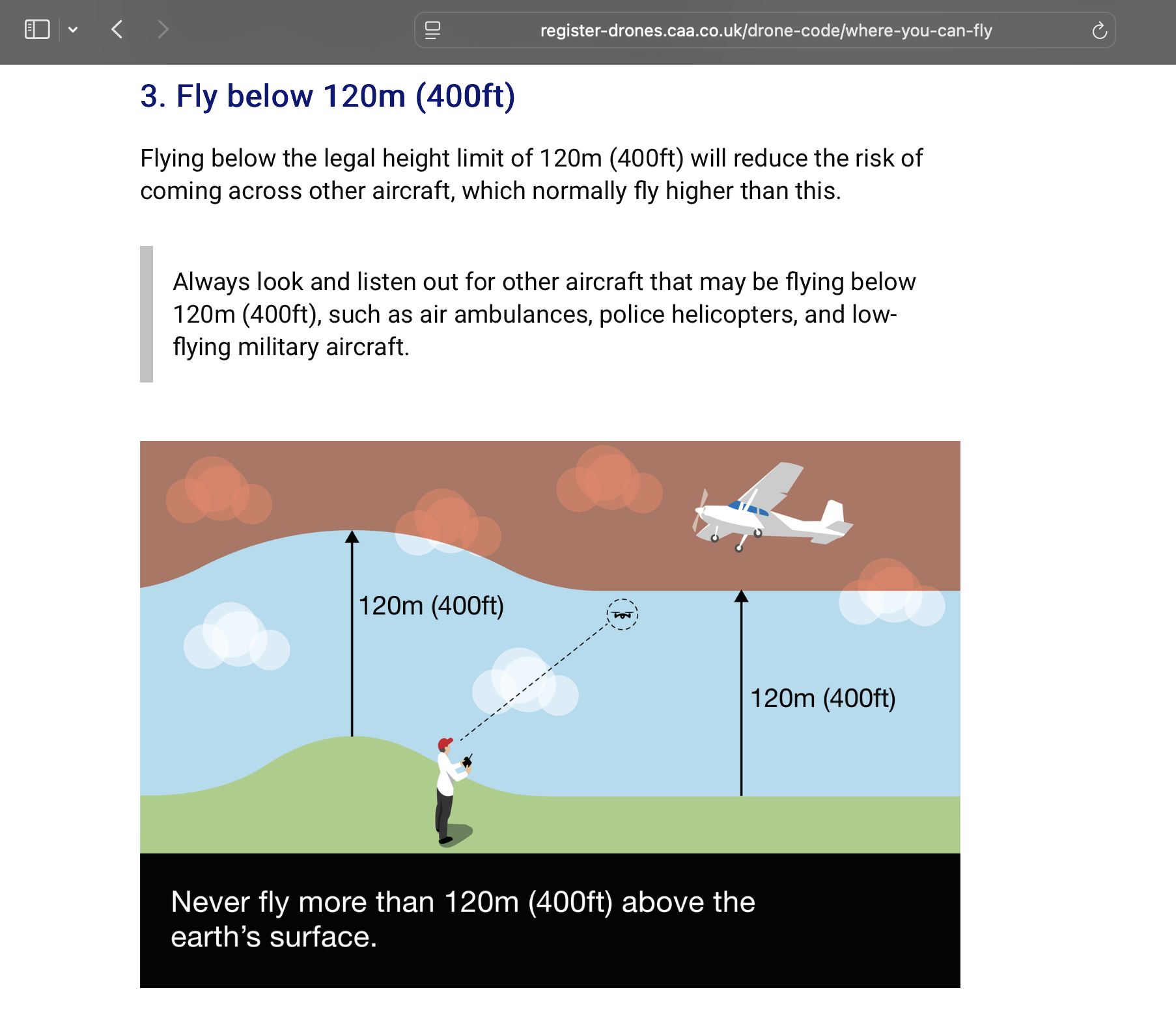

All covered in the CAA DRONE code -

The drone code actually states the nearest point on the earths surface, this may not necessarily be the ground below you. :slight_smile:

I am still puzzled by the altitude thing. I can’t find a DJI site saying my mini 4 pro has a barometer though these are as cheap as chips now. I like the CAA picture but if the drone is using gps for height (which has high error bars generally) and also measuring height above take off position can you…
  1. Fly up the side of a mountain maintaining 120m above ground level? Violates 120m above take off point but meets CAA rules
  2. Fly off a cliff greater than 200m high. Nominally drone would allow 200m cliff + 120m above take off point. Also it sees negative altitude from launch if you descend so is this ever an issue eg RTH. Would break CAA rule. Does drone descend to 120m never to be able to climb up to home point.

This is correct for flights under EASA regulations, but under the CAA Regulations maximum allowed height is not stipulated from the Take off Point, but the nearest point on the earths surface (taken from a point directly underneath the drones position in flight). The diagram at the link in the regs provided by Suzanne above shows this clearly
“If you fly where the ground falls or rises, such as over hills, mountains or cliffs, you may need to adjust your flight path so that your drone or model aircraft is never more than 120m (400ft) from the closest point of the earth’s surface.”
Thanks. That was my understanding. I was wondering what rules the drone follows in terms of altitude in the above scenarios. Does it terrain follow? Does it aallow you to show actual altitude?

Your explanation is correct if you delete the above 11 words. The CAA rules state from the closest point on the earths surface; this does not have to be directly underneath the drone.
