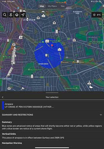

Hello, I just had a few questions about Drone Assist - I have a sub 250g drone and if I want to fly around London, I was just worried about the rules and regulations about where to fly.
  1. What does a blue zone airspace mean, and does that mean I can’t fly there?

Would I be able to fly in this blue zone?
What do you read into it?
It just says it’s a hazard, I’ts not really clear if I could fly. (sorry for the amount of questions lol just don’t want to get in trouble as a new drone flyer)
Same with this zone around London. It’s a red zone but it specifically states helicopters, I’m not sure about drones.
Then its just helicopters, switch on and off the layers to see the varios restritions and use the share link to share that view
