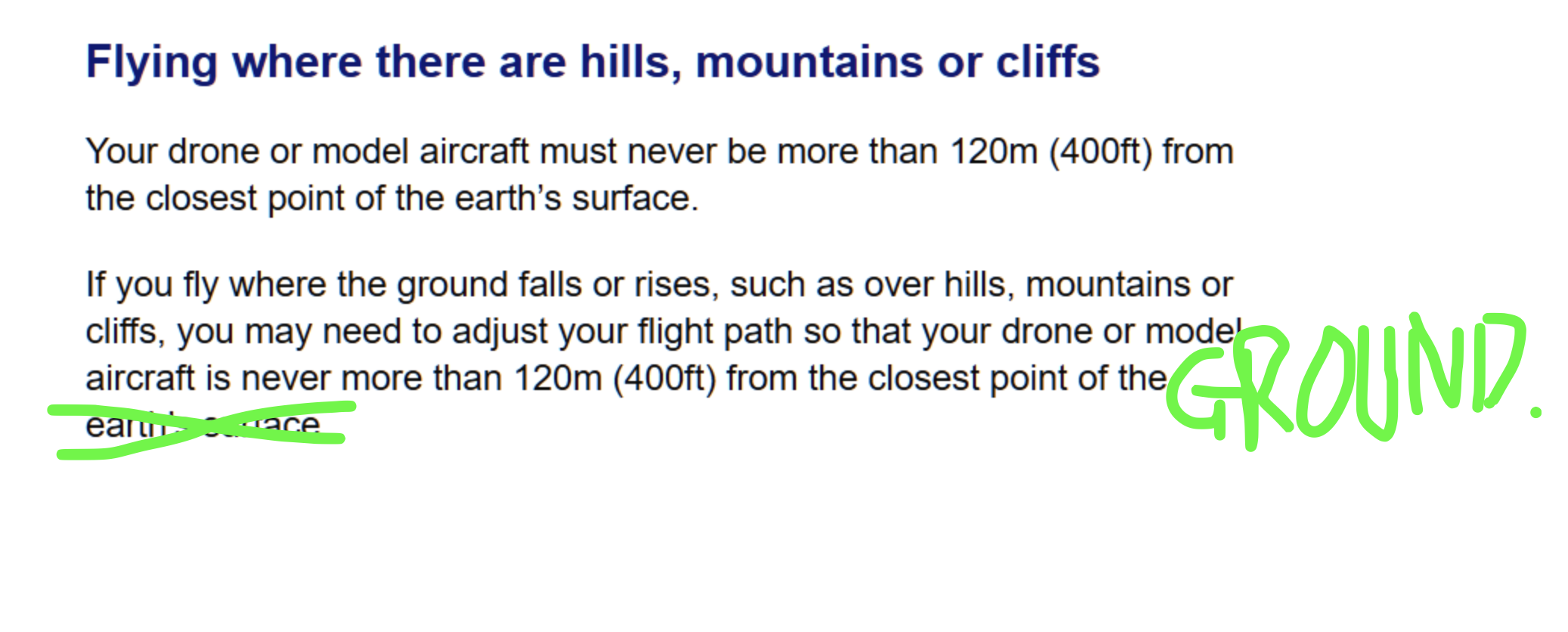

Or we could all just apply some common sense and read the rule as:
Which is what this picture depicts:
