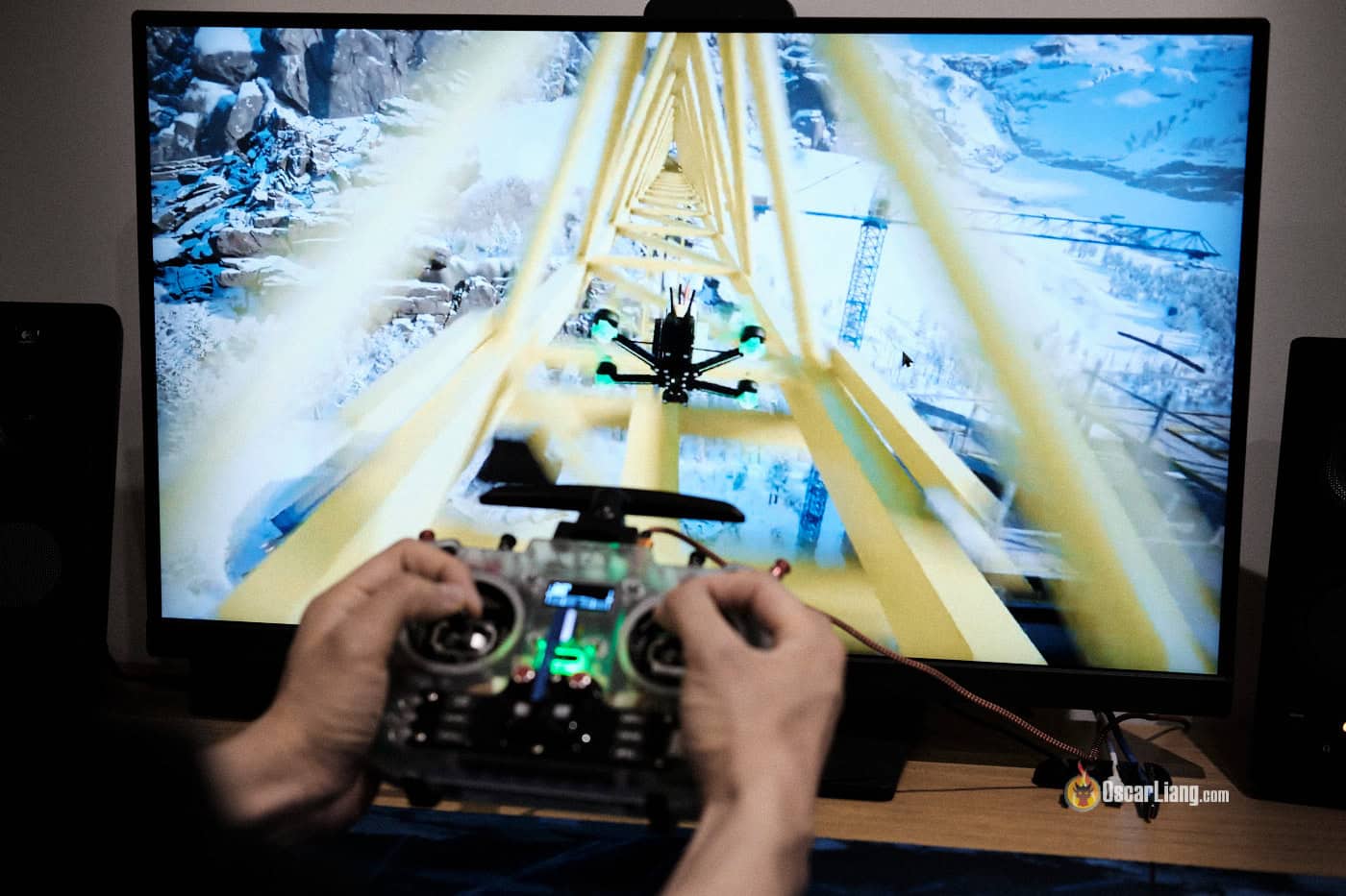

Ok, so to get started and get practicing on the simulators what kit will I need to get going ? Sorry that may sound like a silly question. lol
No silly questions (only silly answers :slight_smile: ).
You will need:
  • Something to run the simulator on: PC/Mac/Phone/Tablet

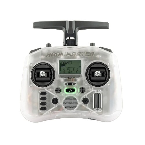

  • A controller that can connect to the simulator
  • The simulator software
A fairly common, and cheap, setup for PC would be the Radiomaster Pocket controller and one of LiftOff/Uncrashed/Tryp on Steam.
While simulators do have subtle differences in their physics and how they behave, for a beginner they are all much of a muchness, and equally viable as a starting point. Given that you’ve said you’re aiming for cinematic, Tryp might be a good option.
