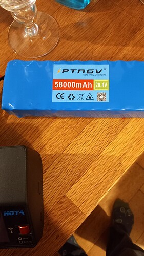

Field charging with a 7s3p
I’ve got this whopper 7s3p lion battery for field changing, but lo and behold, having charged one 6s battery from storage to 99% my Hota D6 pro, just shuts down. Is it the wrong battery, or just cheap and rubbish…?

Is this the battery
https://www.aliexpress.us/item/1005005801160557.html?src=google&aff_fcid=ff9787e376be419f823a2982e194693f-1697372523406-06587-UneMJZVf&aff_fsk=UneMJZVf&aff_platform=aaf&sk=UneMJZVf&aff_trace_key=ff9787e376be419f823a2982e194693f-1697372523406-06587-UneMJZVf&terminal_id=3b96dc3d59bf4cb2a7a68db9e472242c&afSmartRedirect=y&gatewayAdapt=glo2usa
Was it fully charged
Yup, thats the battery…
It was fully charged, and i took no more than 800mah out of it when charging the 6s lipo
The big battery’s voltage went from 29.4v to 25ish volts during that one charge. It seemed to stop as the 2 batteries reached equal voltage.

Well, I’ve found the problem… I tore the battery pack apart, tested each 18650, and found a load of duds that were dropping voltage FAR too quickly, so the overall pack voltage dropped below the level that its BMS was happy with - and it cut off.
So I’ll replace the duds, buy a spot welder, rebuild it, and see what happens.
Beware dubious cheap chinese batteries, is the real lesson here I feel!

Well the pack itself is rated at 58,000mah.
Its a 21 cell 7s3p. So they’ve laughingly added ALL the mah together AND assumed they averaged around 2700 each, which is at best - generous!
In reality they were around 1000 each with some in the low 100s.
So if there are 3 sets of 7 in parallel, am I right in thinking the average mah per battery is multiplied by 3 to get the effective mah capacity… which in the case is 3000mah at best?

There are 7 batteries in series, in 3 banks in parallel
The banks have a nominal voltage of 25.2v/2700mAh
as they are connected in parallel the Ampage is tripled
So the pack is 8100 mAh
