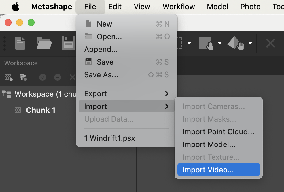

I’m not sure if the trial version of Metashape has the option, but you can import a video file. The file type is important (I use MP4 ), and you have to specify an output folder for the .PNG files the import converter creates.
Select a frame step - depending on the size of the video, too small a frame step results in hundreds of PNG images, which will make subsequent Metashape processing take much longer.
