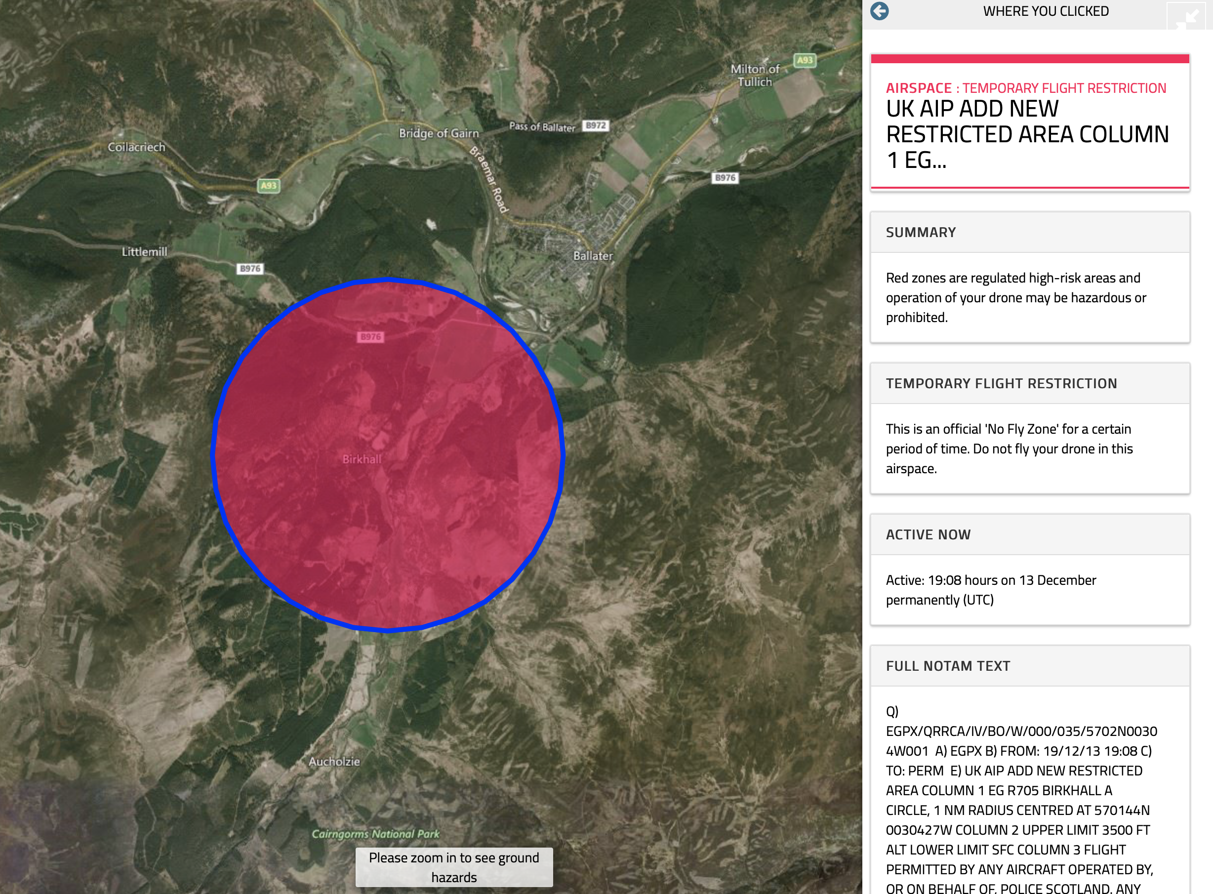

Have had a few emails back and forth with Altitude Angel to clarify the situation with the Highlands Restricted Area.
Currently there are no NOTAMs in place so it isn’t active, but it exists so shows up on their data and clicking on it gives a general notice to exercise caution and stay within the drone code.
As and when NOTAMs are issued to activate the HRA the outline will change to blue (as per other NOTAMs) and the additional details will show up in the information when you click on it.
You can see it for R705 Birkhall, which was made a restricted area via NOTAM in 2013:
[edit: worth noting that the outline for the Birkhall FRA only shows blue when you click the details for the NOTAM…]

Yes, and it’s usually not something you need permission for… since the Highland Restricted Area is only active if there’s a specific notice in place to activate it, if there isn’t you can just fly.
Basically, if you click on it in the map* and it just gives the generic “Fly to the drone code” warning, you’re fine and can put the drone up (within the drone code).
If you click on it and there’s a NOTAM showing (as in the video I posted above for Birkhall) then read the details and see what it says. It might be the HRA is to be activated in the coming weeks and it’s advance notice, might be that it’s active now and you can’t fly. Will depend on the circumstances.
Bear in mind that the HRA is actually made up of four different restricted areas so zoom in on the map on the specific area you’re flying to be sure you’re checking the right part.**
