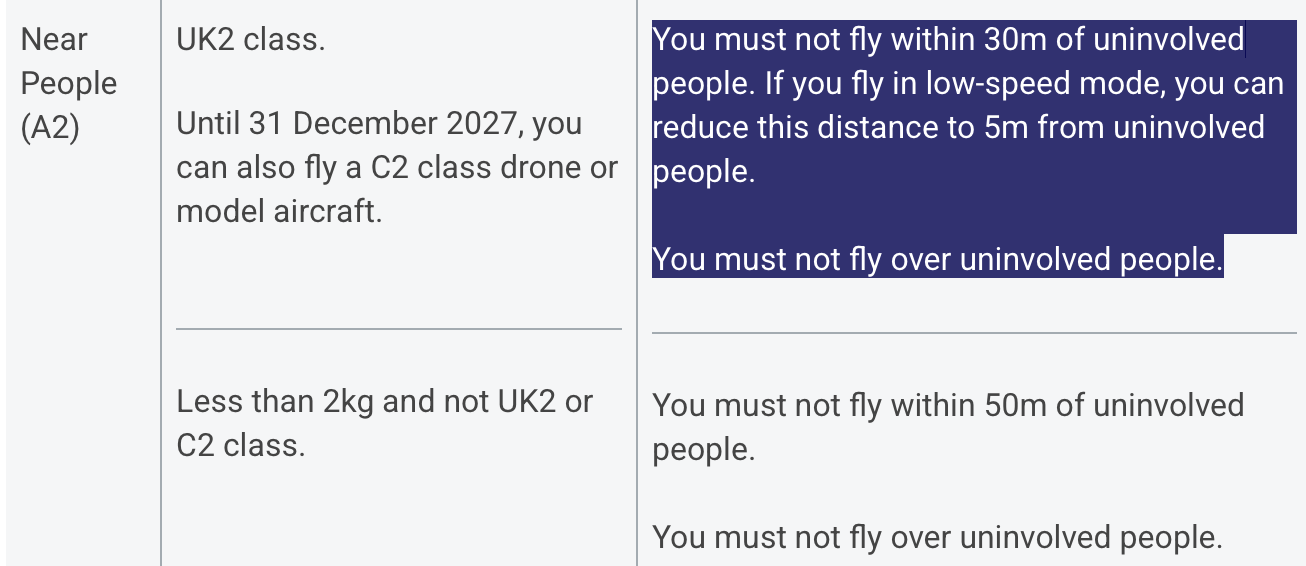

Your Mavic 4 Pro has a C2 classification, which means you can fly it as UK2 (until the end of next year) in the “Near People (A2)” category.
The “you must not fly over uninvolved people” bit is why you can’t just fly it over a town in low-speed mode, so (abandoned or not) it’s up to you to decide if you’re certain there are no uninvolved people in your old windmills, etc. If you are, have at it.

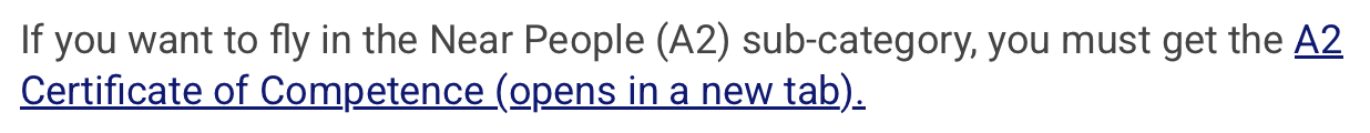

Except… The reason the A2 CofC is key is this:

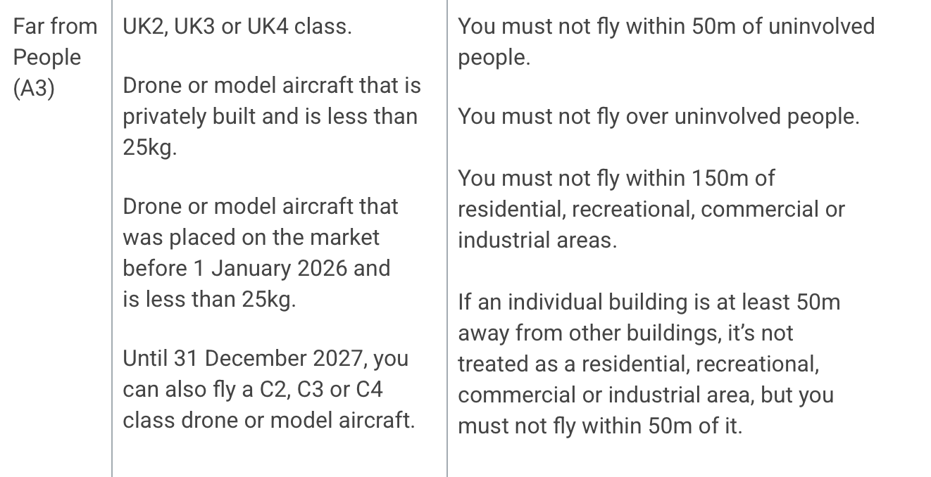

If you don’t have the A2 CofC then, C2 stamp or not, your Mavic 4 Pro is relegated to “Far from People (A3)”:
Notice that in that category you need to stay away from buildings (whether they’re occupied or not), and there’s no get-out-clause of “unless said building looks really old”.
Regardless of the abandoned buildings part of your query, I’d say that if you’re flying a Mavic 4 Pro it is well worth your time and money to get yourself an A2 CofC (don’t forget to check on the discounts for Silver/Gold members). Not only does it open up your options for where you can fly, it will also help you understand the rules more (which is the main reason I took it).
