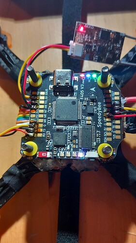

So I got my fancy new Speedybee F4 v3.
And I’m having a mare trying to setup my Flysky ibus system. The receiver and transmitter are just not talking.

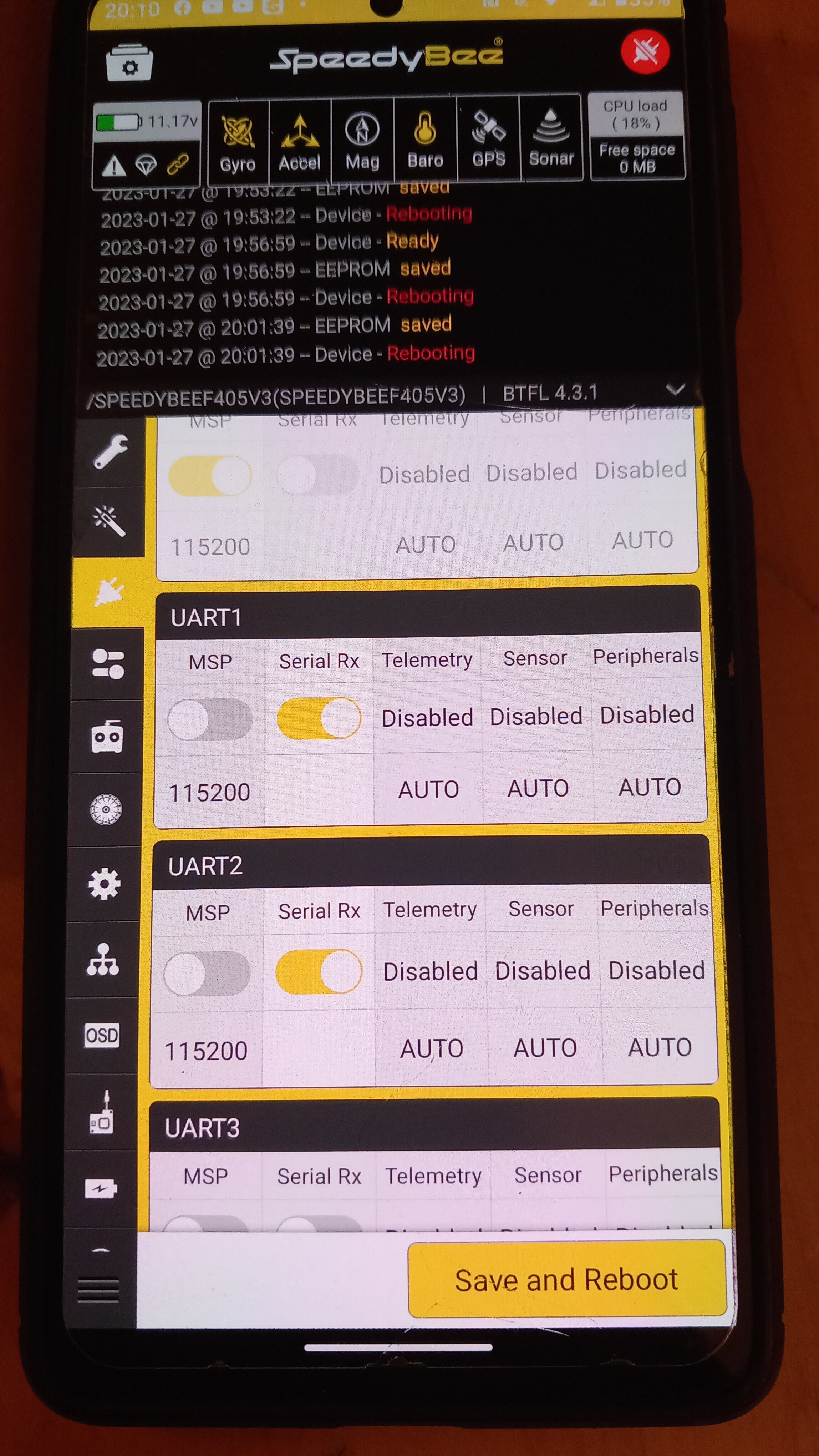

I’ve turned on Uart2.

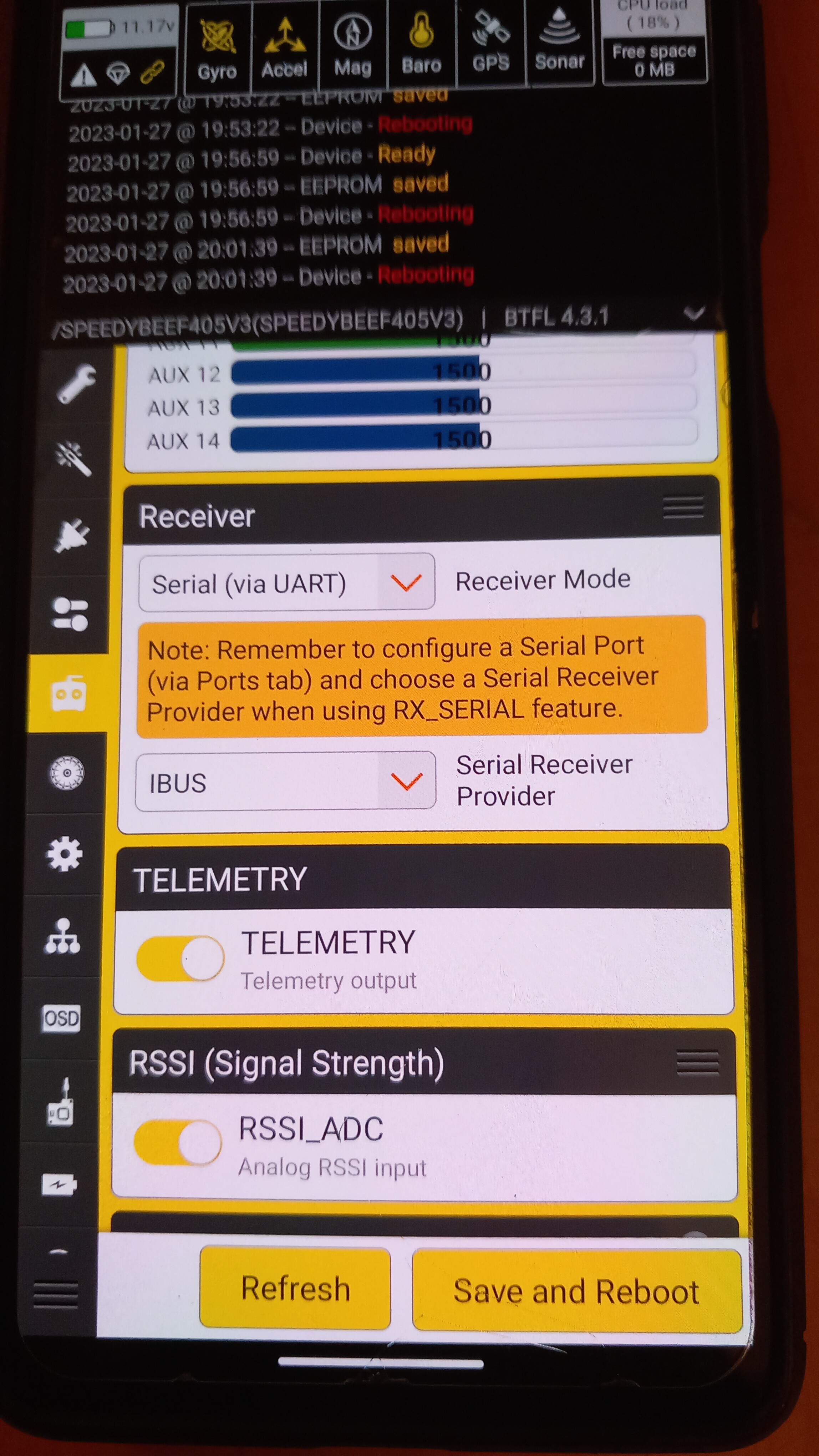

Switched the receiver to ibus in betaflight.
Do i need to adjust something on the transmitter?
This is soooo complicated!

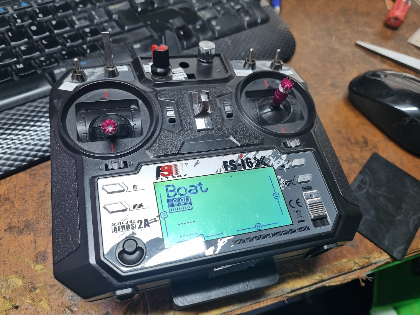

What tx do you have? It will probably have an sbus / ibus option
Flysky fs-I6x
Are you suggesting changing to sbus and moving yellow rx wire away from r2 to sbus?

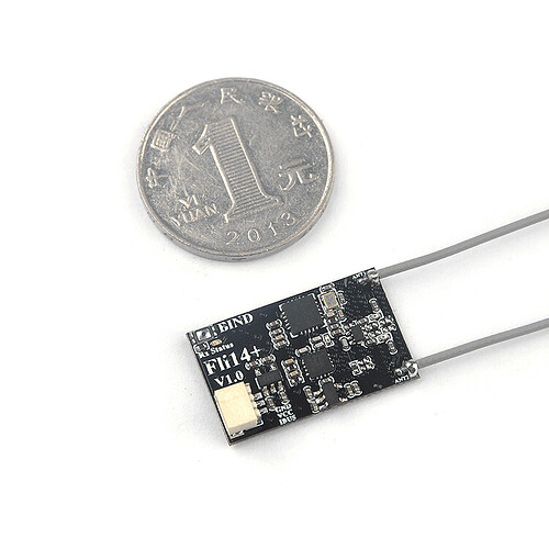

What rx is it?
Looks like a Fli14 rx. Was looking at one the other night on Amazon for something else.
So ibus only.
Try using uart 1 rx. And make sure only uart 1 ‘serial rx’ is enabled.

He’s wired to R2… So only uart 2 should be set to Serial RX in the BF config.
I’m convinced its a tx setting. Switch off ppm, and select ibus.

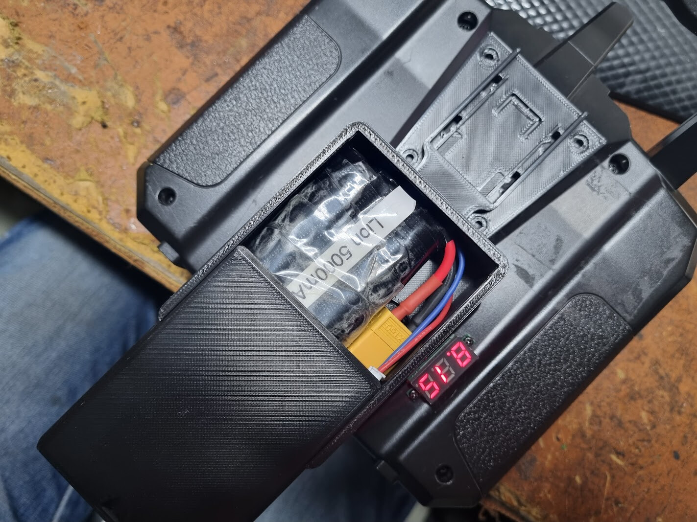

I have one… in fact I’ve just been modding it to have OpenTx and to take a 2S 5000mAh Lion battery pack.
Next up is an ELRS module.
Mine doesn’t do that any more… you have to go through all the OpenTx menus now. :slight_smile:
