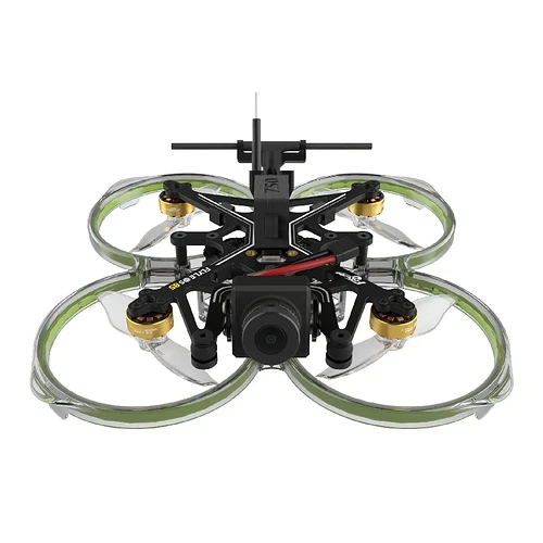

Hi all. So after my last post and wasting 2 days trying to connect an analogue quad to a digital head set I’ve been looking for a whoop to connect to my walksnail avatar goggles L. I’ve come across this:
I’m as green as they come when it comes to quads. The mobula 8 walksnail I wanted seems to be out of stock in most places. Does anyone have any other suggestions that would work with the walksnail avatar goggles L and radiomaster pocket radio (I already have both).
  1. Flywoo FlyLens 85 HD Walksnail 2S £254.99
  2. CaddxFPV Gofilm 20 Cinewhoop W/ Walksnail Moonlight 4K - Unmanned Tech Shop N4RxHNCV07WVpvb4Mrg4WkPkEGOoHIQCwqcuHj5mRQT6OuD £314.90
  3. HappyModel Moblite7 Walksnail V3 1S 75mm HD Brushless Whoop SuperX HD ELRS AIO EX1002 KV20000 Walksnail Avatar Mini 1S Kit - AliExpress 44 £206
  4. Meteor75 Pro Brushless Whoop Quadcopter (1S HD Digital VTX) – BETAFPV Hobby £200 - out of stock
  5. https://flywoo.net/products/firefly-1s-dc16-nano-baby-quad-walksnail-v2.0-bnf? £254.37 GBP
  6. https://flywoo.net/products/explorer-lr-4-hd-walksnail £264 GBP

I have this quad. It is nice. Looks good with the led lights.
Make sure yo order the version with ELRS installed.
The GPS version from flywoo direct - I could never get the GPS to lock.
Three issues -
1 - like all walksnail/dji digital the video could overheat if left on and not flying - so either turn-off, set warning or make sure standby mode is set in goggles.
2 - No buzzer - so make sure you set motors as buzzer in betaflight and or find from remote or add an standalone buzzer.
3 - It is easy to connect the battery the wrong way and bust your drone. … ask me how I know this!
Lovely drone - but expensive.
Again - watch over heating.
No buzzer
Also needs a microsd card.
I do not have this drone and have not used this seller. But it is on my potentila buy list.
In stock
Most matches the analogue whoop your brought.
Could be flown indoors.
No buzzer

Because of this thread I braved the soldering iron and fixed the FlyLens85
surface mount resistor blown off.
Only lift off one pad
Levered it back down and did minimal solder. (I think none but I worked so I just stopped)
I am not sure what other damage the reverse battery caused (external LED maybe)
But limited light outside to test it outside working hours.
:+1: Brendan
but you ought to reflow the joint at each end, bit of flux, minimal amount of solder and make sure one end has cooled before you do the other.
