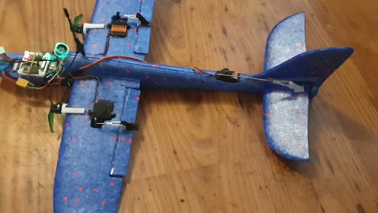

4 foam gliders complete with LEDs arrived this morning.
I know @Steviegeek is doing the rear flap a different way, but this is how I’ve done it. It hasn’t been fully tested, but it goes up and down, left and right in the garden.
I may scale the throttle in my tx as its way overpowered.

I do like your elevator…
However I also rather like the single servo ailerons.
So do I . Never considered doing it this way.
Where did your 3d prints come from? links to stls?
My Zohd Nano Talon Evo does much the same thing.
Did them myself. Printed in tpu, and glued on. For thfs motors…
