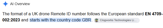

Are you sure its the Remote ID and not your Fly / Operator ID ? The CAA site has a section for your Remote ID and it has a special 3 digit / character check sum at the end of it that you need too.
Seen quite a few people think its the same but its not - similar but not the same so check that your using the right thing.
On my RC2 I have it in for my Avata 360 as its a UK1 drone but not for my Air 3s as its a C1 drone ( no UK markings on it ) and it seems to work fine ( MMM do need to double check that its not got the RID in for the Air 3s but I didnt put it in and it does do a firmware change when you change drones )
But the remote ID in the UK does start with GBR.
the format on my controller is as follows
GBRxxxx9xxxxxxxx
Only the GBR is in capitals the rest is in lowercase
I get the format error message as soon as I type the first “G”. Indeed the error message comes up no matter what letter or digit I try to input
