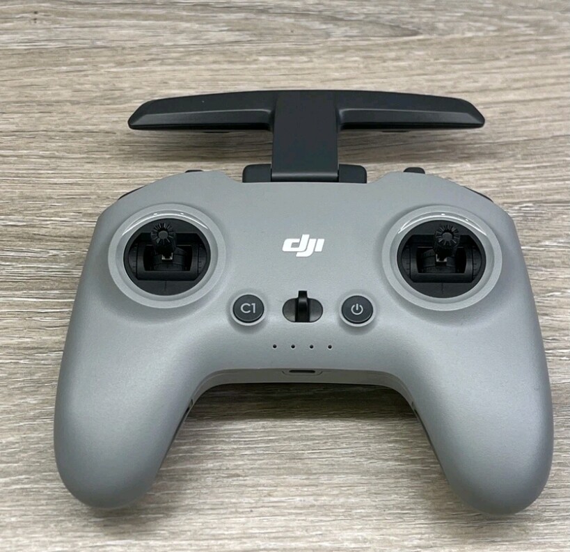

Not sure if i misunderstood you but you can use a controller such as the dji fpv controller such as
with the avata and not wear the goggles you would of course as stated have jurry rig a seperate duspkay so you can monitor the battery life.

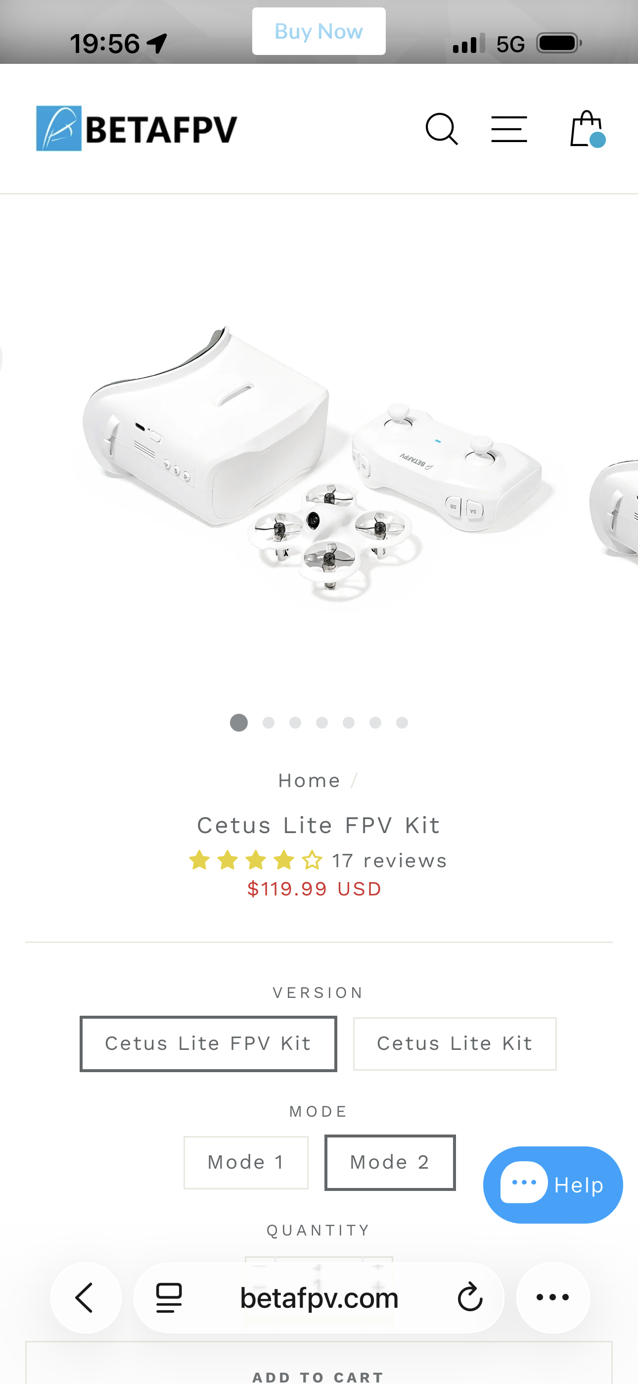

Maybe consider starting out with a small analogue tiny whoop.
Something like / similar to the BetaFPV Cetus Lite FPV kit.
IMG_2971
It’s not expensive, has some minimal safety / flight assist features and will get you going, until your sure if FPV is for you or not
