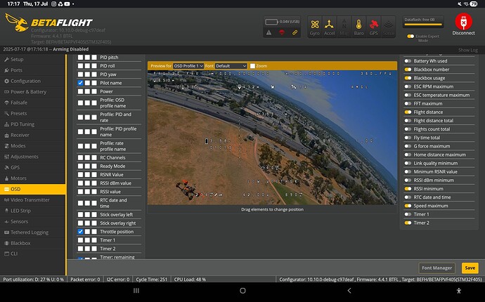

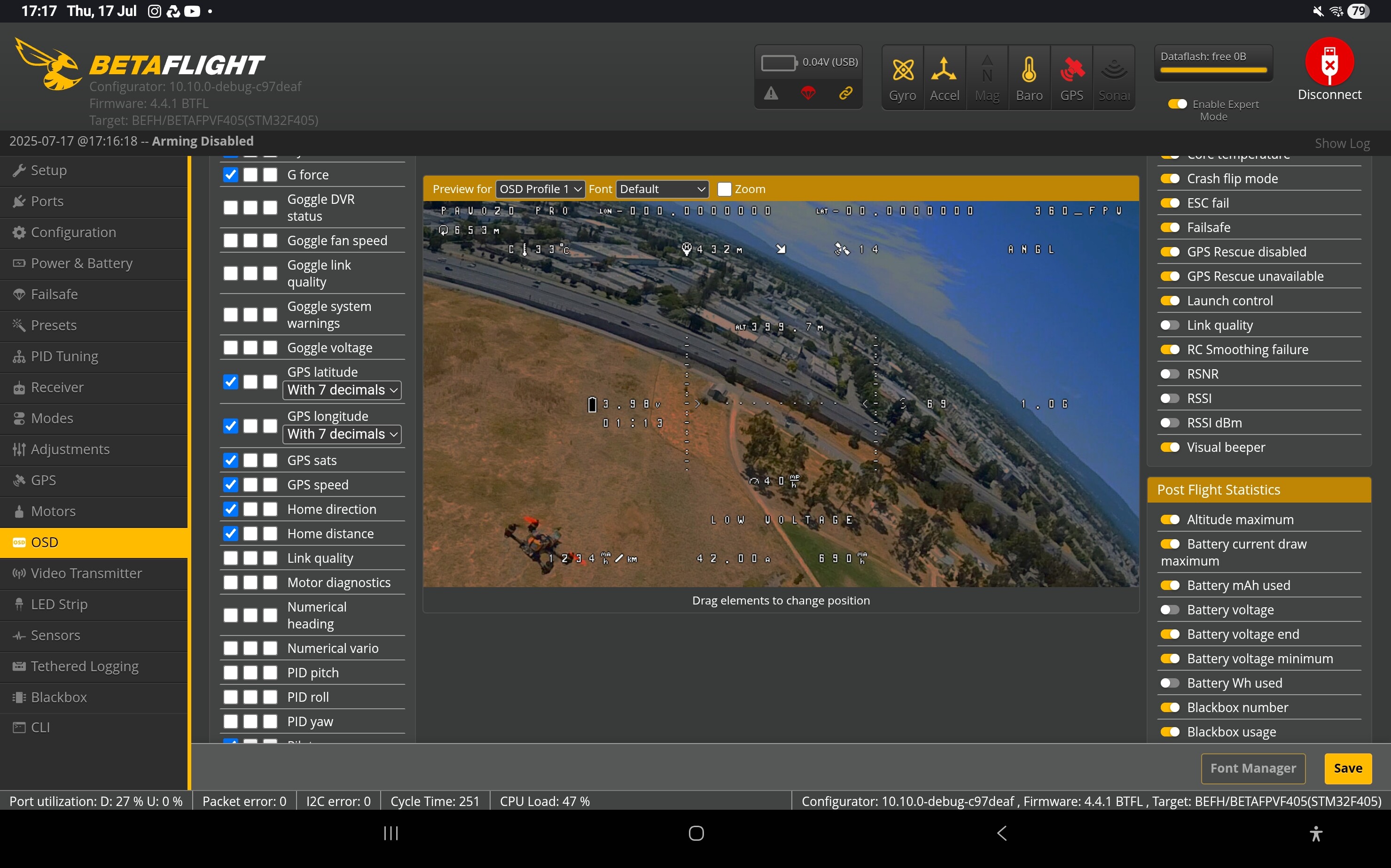

Paul, you’ll need to select the appropriate options in Betaflight, to get the summary at the end of each flight.
That option is usually defaulted to be on, with minimal information, however you may have disabled it, when tinkering to set up you OSD.
It’s on the bottom right hand side of the OSD settings page.
Cheers Jason
These are the screen shots of my settings.
Do you use auto recording as i think as i land and hit disarm it stops. Also when i crash it stops.

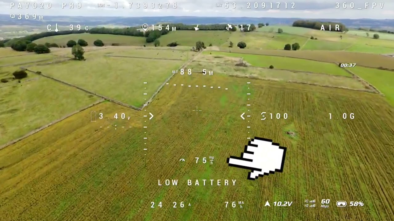

@Cedric i managed to get 71mph tonight with a lighter battery and a little breeze.
Full video attached :grinning_face:

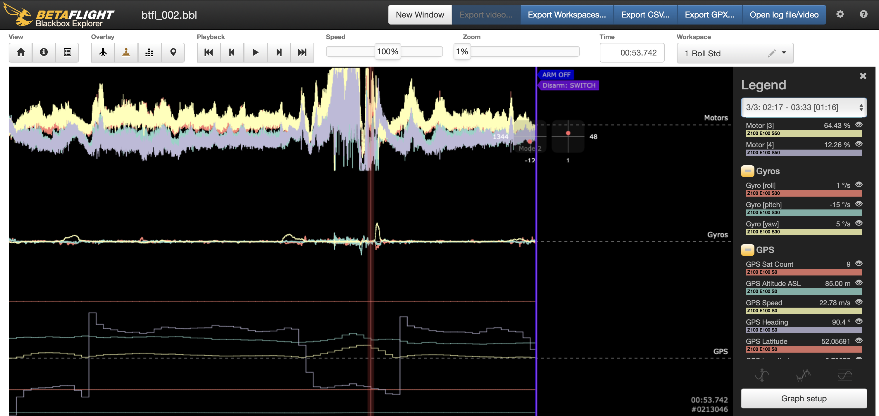

Boosting my own 2" record a bit. :blush:
New props, fresh battery… and a wee bit of a tailwind this AM.

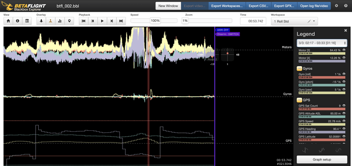

22.78mps = 80.008kph = 50.95mph

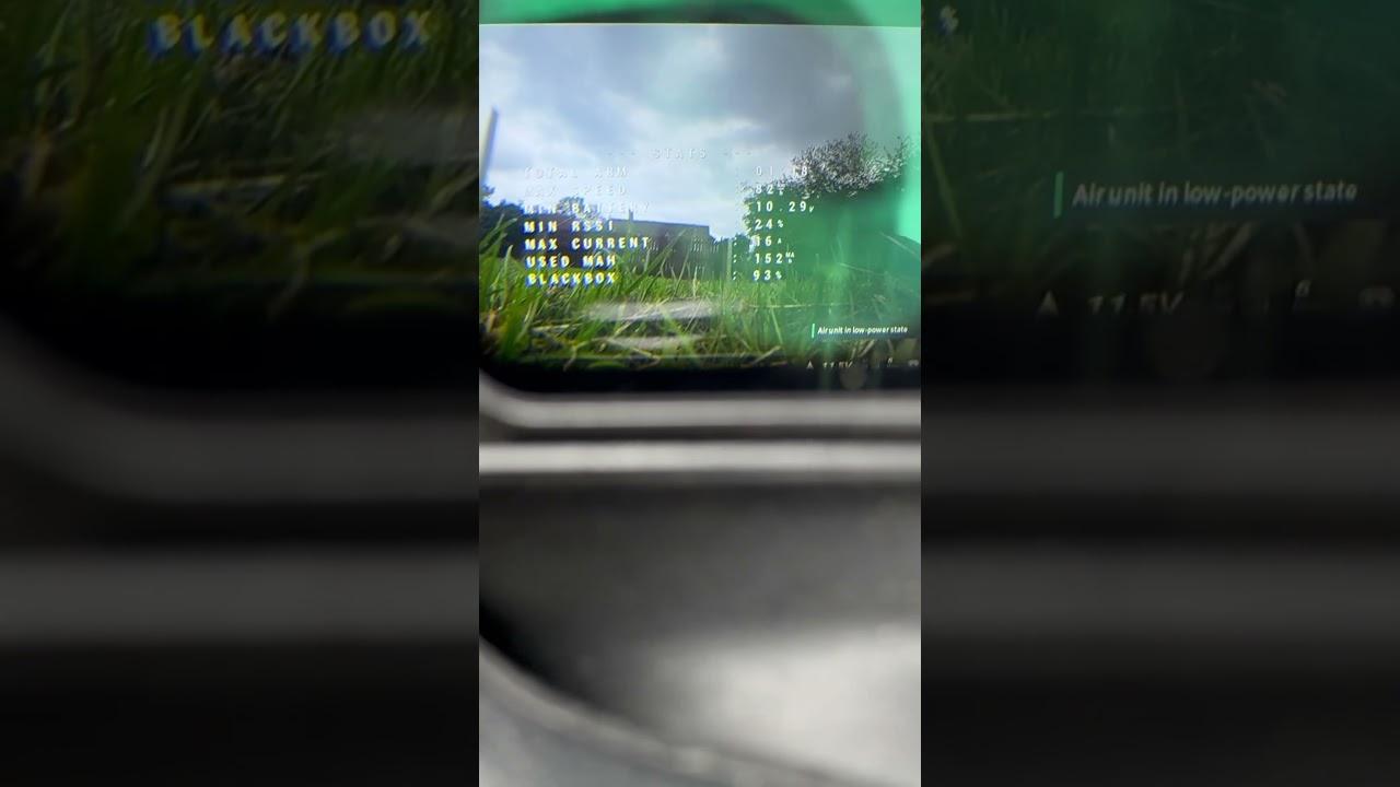

bbl shot - with 9 sats :innocent:
I don’t have recorded OSD.. so I got a quick shot post landing of the goggles screen. Yes, I had to squint :joy:

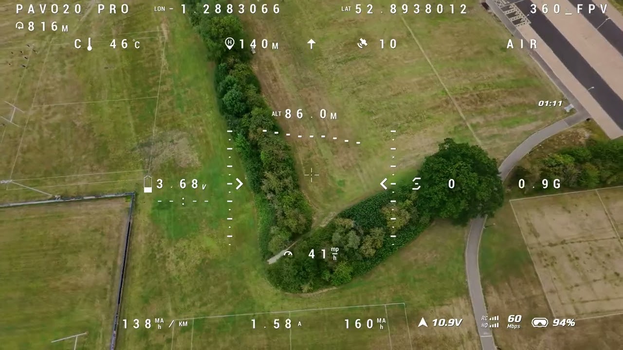

Hi @Cedric
New record set fot the Pavo20pro 76mph
Was a little nervous about the vibration tbh. Maybe i can tune it out.
Will stop when i hit 80mph :wink:

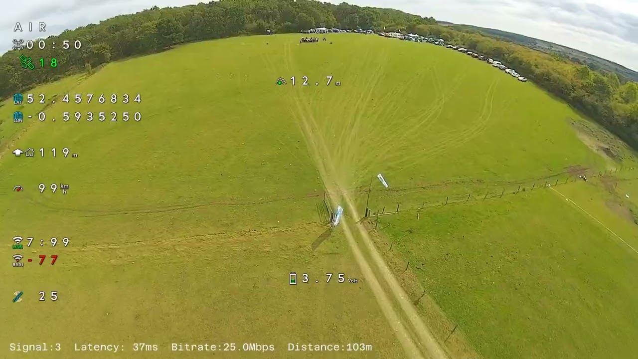

As mentioned in the Big Meet thread - managed to hit a new speed record with the HS5 at the meet today - 317km/h or 197MPH. Great support from the club members - and pretty sure we can go a bit quicker still :wink:
The build:
https://rotorbuilds.com/build/33349
Tomorrow 200mph :grinning_face: no pressure
