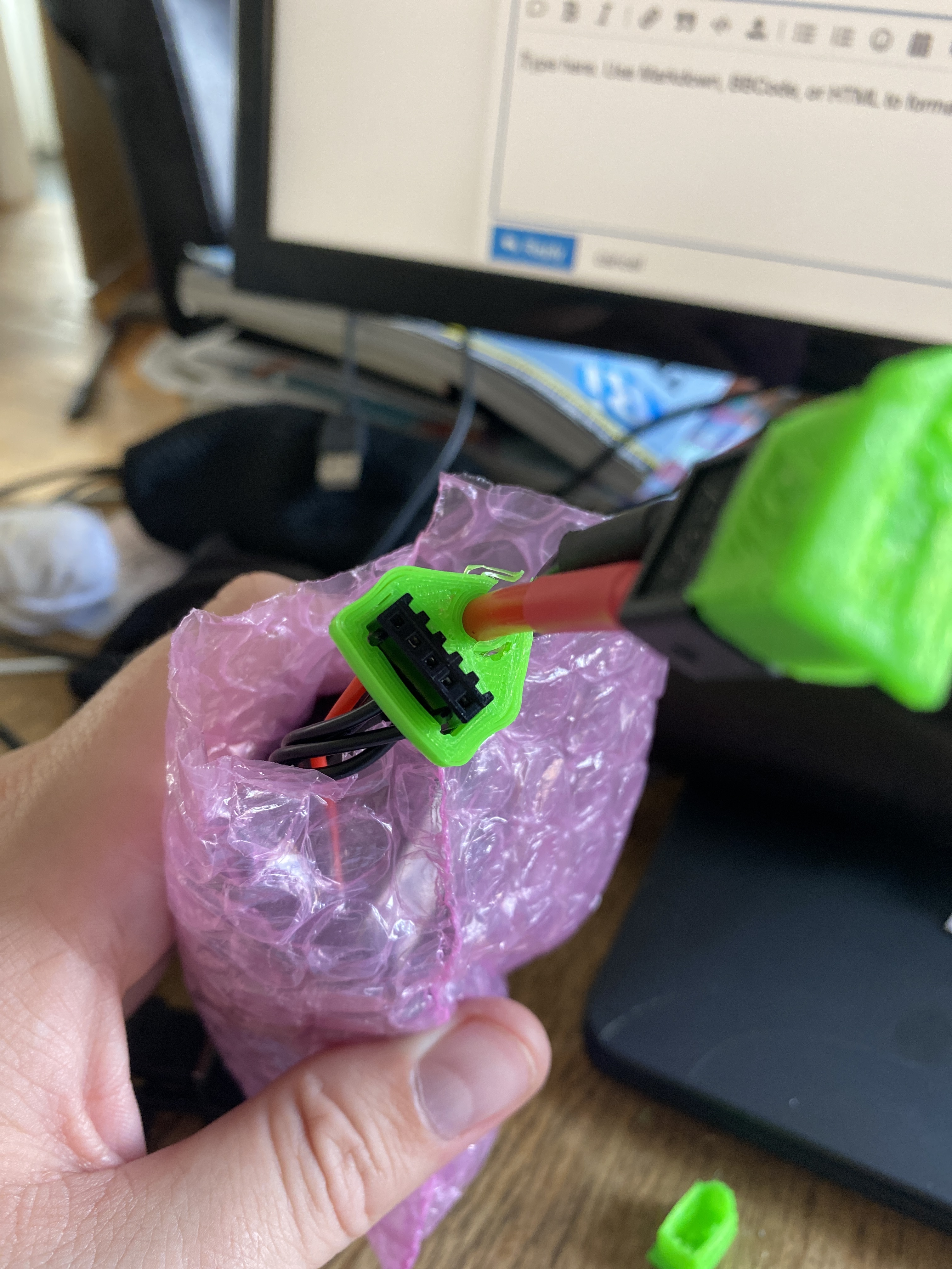

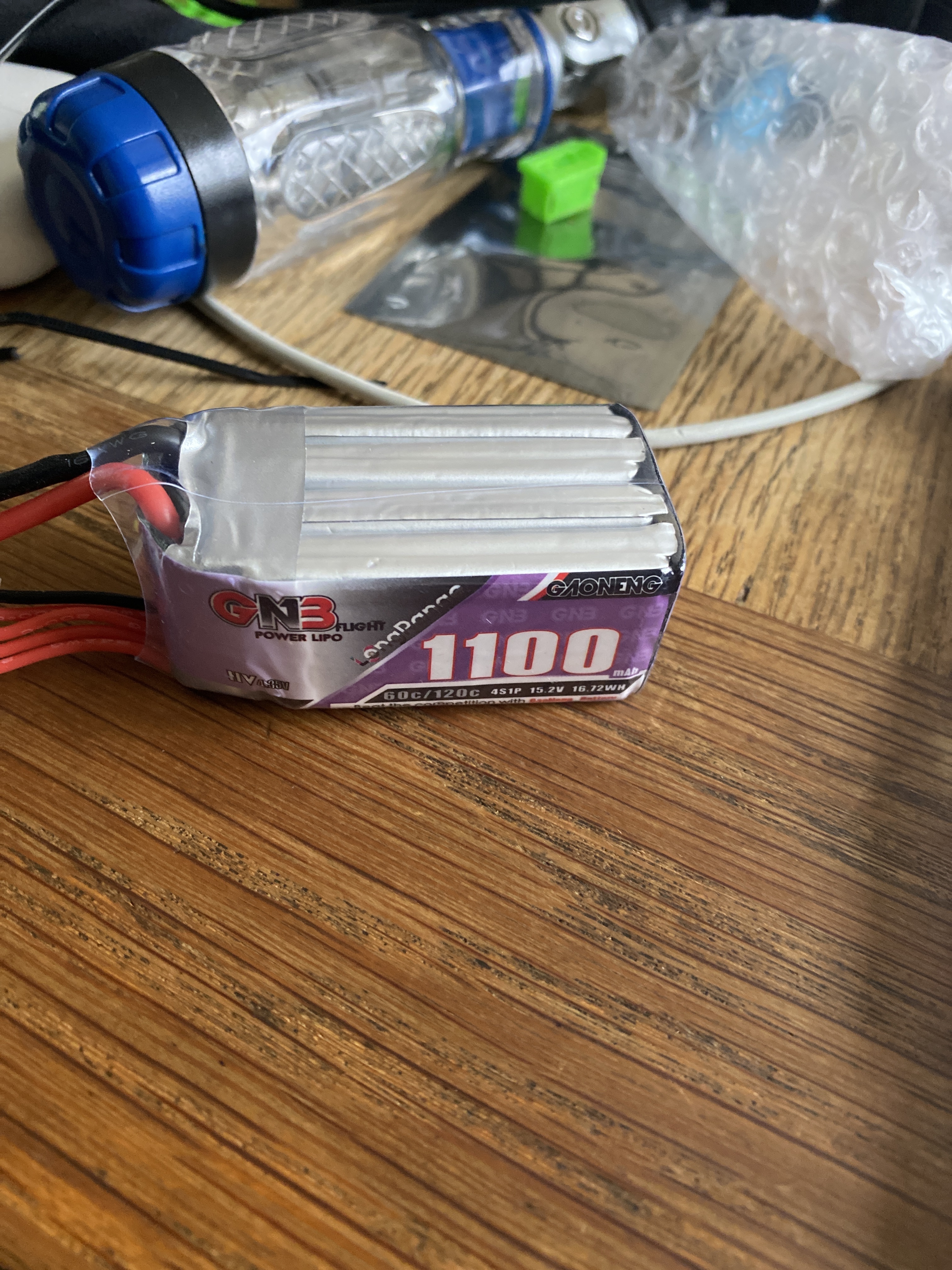

I’ve had 3 of these batteries break on the balance cable and register from 4s to 3s on my charger.
The batteries that have broken have all been the same GNB 1100mAh 4S
Luckily I’ve managed to “rescue” one of them but one has had to go in the bin and the other is on the bench for surgery later today.
I’m going to message Hobby RC but don’t expect much as their policy states they are only covered when dead on arrival.
Just wondered if anyone else has had the same issues?

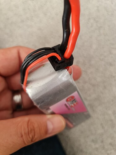

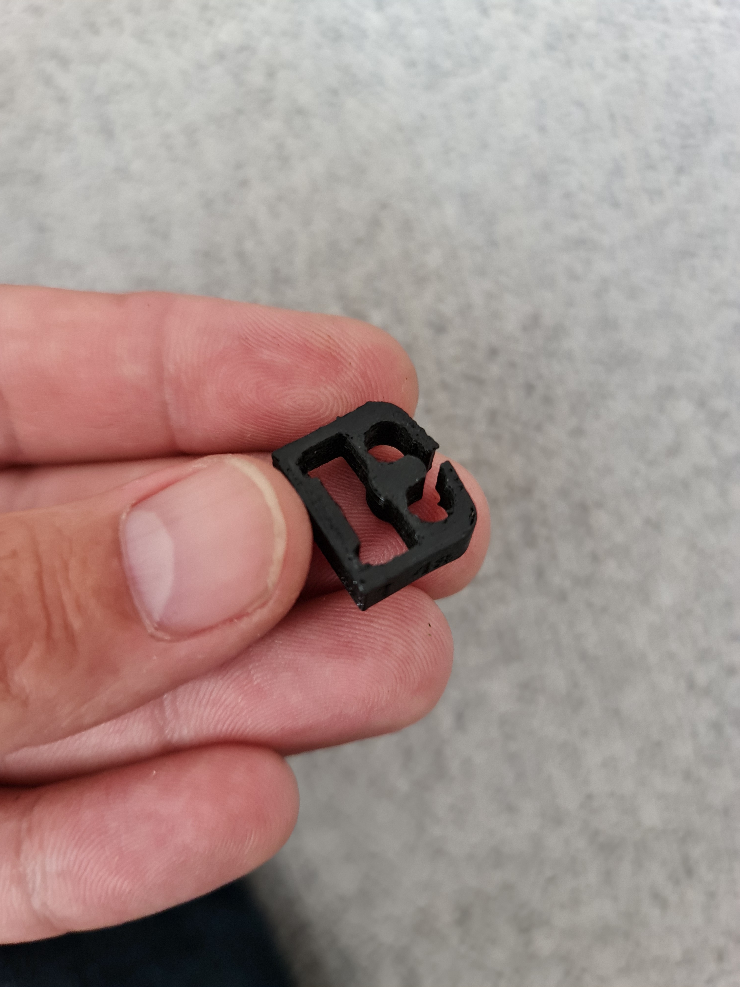

That could be the issue mate, when the battery ejects it will be putting all those G forces on the leads pulling out from the straps. @DeanoG60 printed me off some balance lead clips that work a treat. You don’t need to strap them at all so no forces act on the leads when ejected. I’m at work right now but I’ll post a pic when I get home :+1:t2:

These are the small clips that Deano printed for me Howard :+1:t2:

Thanks mate. Printed a load yesterday
Sweet! Look good man :+1:t2:

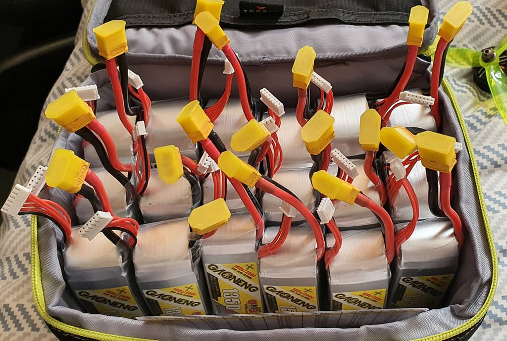

@SirGunner & @Howard78
I like to have a spare or three LOL :slight_smile:
I’m the same with my drones 6 and counting now
