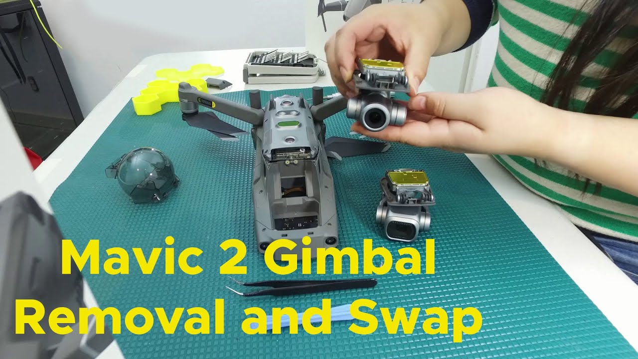

You can see from this video there’s not much room left under the cover once the gimbal module, with the gimbal/video control boards on top, are in place.
