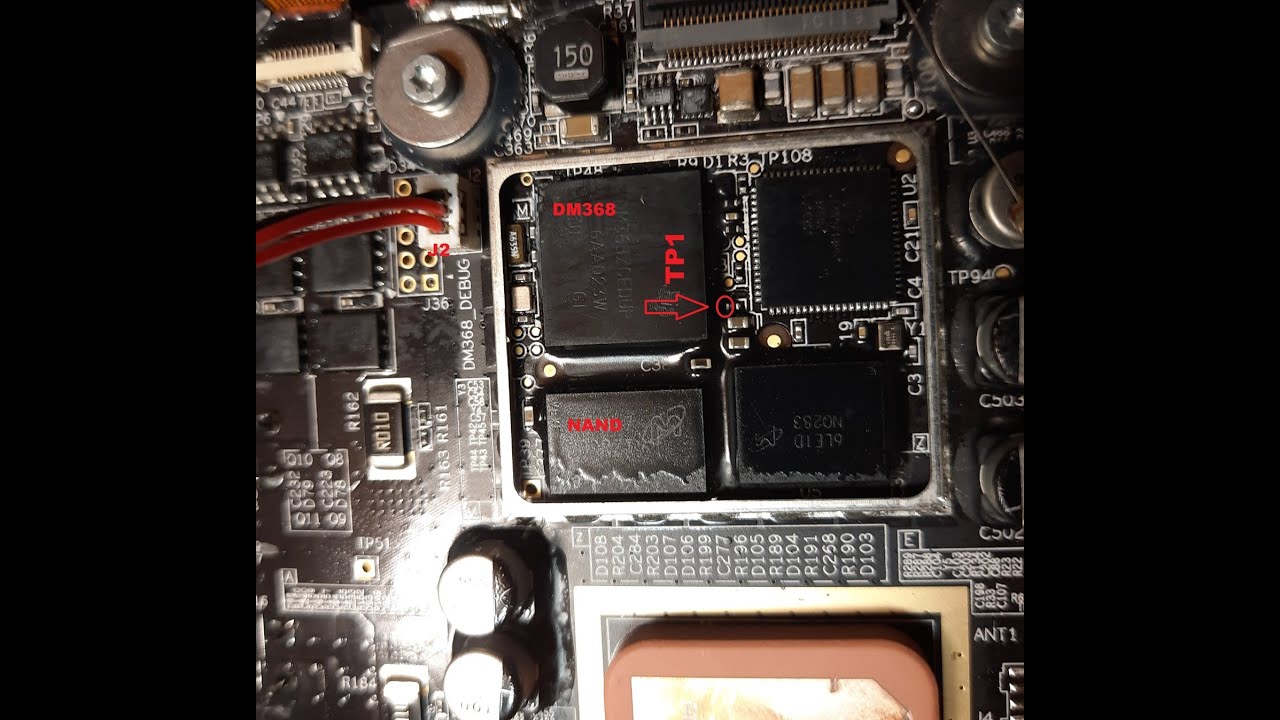

Have a look at this if you haven’t already
I had very few problems with mine up until the pairing issue. I know a lot of fliers did have issues, I must of got a good one? Found it a little too bulky to take everywhere I wanted to take it. Going to look for a DJI when Black Friday is on.
Thanks for the reply, I had seen this video previously. I don’t feel confident in stripping the drone down and messing with electronic components. I will keep it for a few months longer hoping that someone discovers a non intrusive fix. Tried the fix where you try to pair until it auto powers off, but mine won’t even auto shutdown. It just keeps trying to pair until the battery goes flat. That’s one of the symptoms of this fault, drone doesn’t power off using power bottom. It’s a real shame, as up to now I’d had a great flying experience. Will be looking for a Dji on Black Friday
