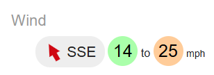

The one nearest to me:
Even the wind direction is almost 90 degrees out.
I am not sure I understand what you’re comparing it with (the picture you shared says “Mavic”, is it from a drone?). Unless you’re standing right next to the station in question, the differences can, of course, at times be significant due to terrain and other local conditions. This is always the case for all weather stations, though.
Nearest station it shows for me is over 7 miles away and is telling me the gust at present is only 1mph! Thanks but I’ll be avoiding that inaccurate site.

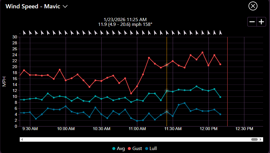

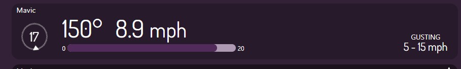

What I’m comparing is ..
  • My weather station - called “Mavic” - a rather accurate one on a pole above my house for good wind readings.
  • The smaller image is what Wunderground shows for the same weather station linked to them.
Ergo - Wunderground is incorrectly reporting the same data source - my weather station.
Readings on my weather station compare very closely to those of Southampton Airport’s weather station that’s just 500m away from me.
The biggest reason to ignore Wunderground is because any tom-dick-harry can link any form of weather station to them .. and you have zero idea where it’s located. Most are “in the garden” and wind it seriously understated and inaccurate.
I see. What time does it say for “last updated at”? This clearly seems like something’s gone wrong, unless it was updated a while ago.
Of course, as with anything, one has to use common sense and consult multiple sources. PWS Network also contains professional stations (e.g. airports and such), not just personal stations.
Mine keeps updating on Wunderground - yet to report a gust above 9mph.
Reality ..
Gosh - it just showed an 11mph on Wunderground .. so about 50% of reality. :man_facepalming:
Southampton Airport ..
Well, I think that shows that its configuration with PWSN is misconfigured, rather than necessarily anything about the site. I’ve just checked a few professional ones nearby (airports), and they match exactly both on their sites and PWSN.
