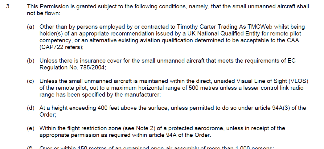

I Just found where it says a maximum of 500m. It’s in my PfCO from the CAA
so others without a PfCO may be able to argue over 500m VLOS, but for me flying commercially I can’t.
Do you have the item in context and not just a screen grab.
I’ll give a bigger screen grab, but this is direct from my PfCO
The thing is now, you don’t need the pfco to fly commercially.
Yeah, That’s why I say i can’t get away fwith flying commercially >500m, but others may be able to, soo long as they maintain VLOS.
I knew I’d seen it say Maximum somewhere, so my apologies for putting my restrictions onto others.
