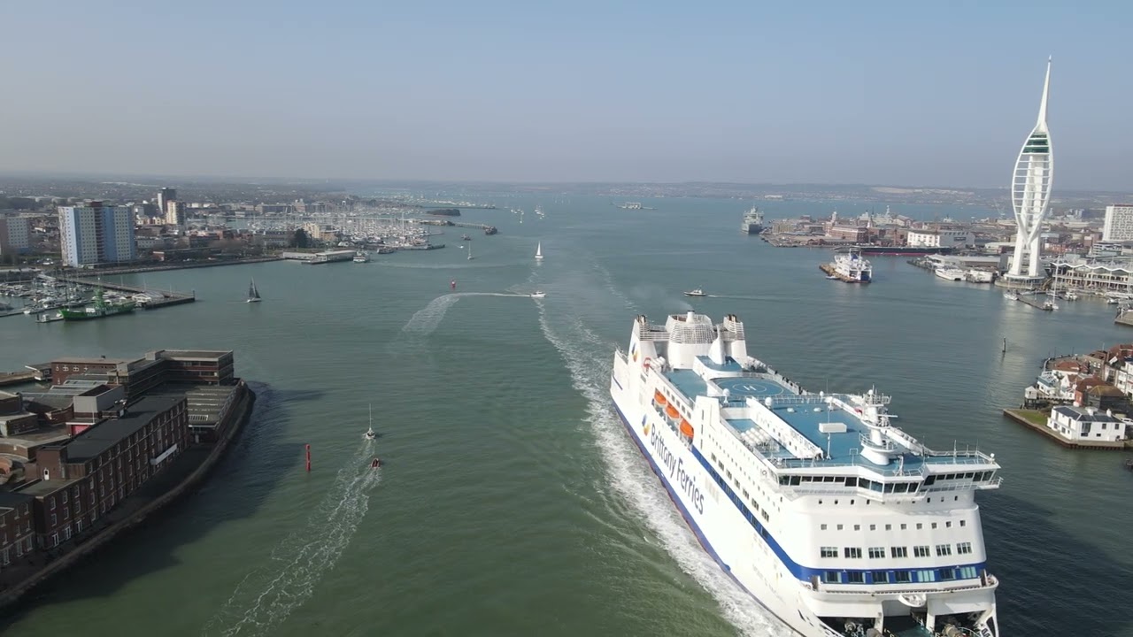

Never had that issue in MANY flights around ships in the solent.

Here’s an occasion when I didn’t lose signal:
Another great point!
Whilst not mine, here’s a large number chasing ships videos with no signal loss taken in that same area.
Search - @richardmarsh888 - Ships
