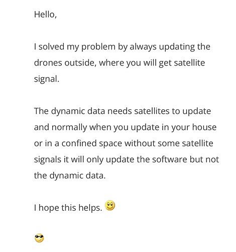

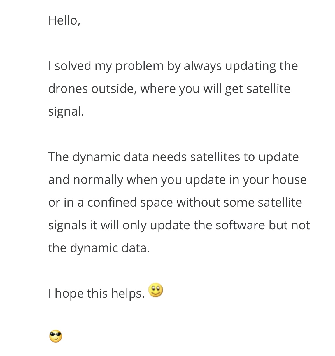

Try connecting the drone / controller ( until you have satellite lock ) then go into settings press top 3 dots on the right, go to fly safe check for update then update if it’s there, hopefully should sort the problem, make sure your ( not ) connected to WiFi ( best to take it out somewhere ) .

Is it showing a fly safe database update available ?
Or try tethering your controller to your phone ( whilst your out ) with gps satellite lock.
It checks it, then says its up to date.
Are you doing this indoors or out somewhere ?
Edit : have you checked to see your running the latest fly app for the updates ? Just read that on a DJI forum so thought it’s worth noting.
Sussed it! thank you, I was missing something from the Geo module on the home screen, if you click on it, it takes you to a screen and it gives 2 tabs to click, one says “licence” the other “flysafe” So i clicked on flysafe and there are 2 choices auto update or import local, I selected auto update, then it uploaded some more firmware, all appears ok now, Thanks for your help.
