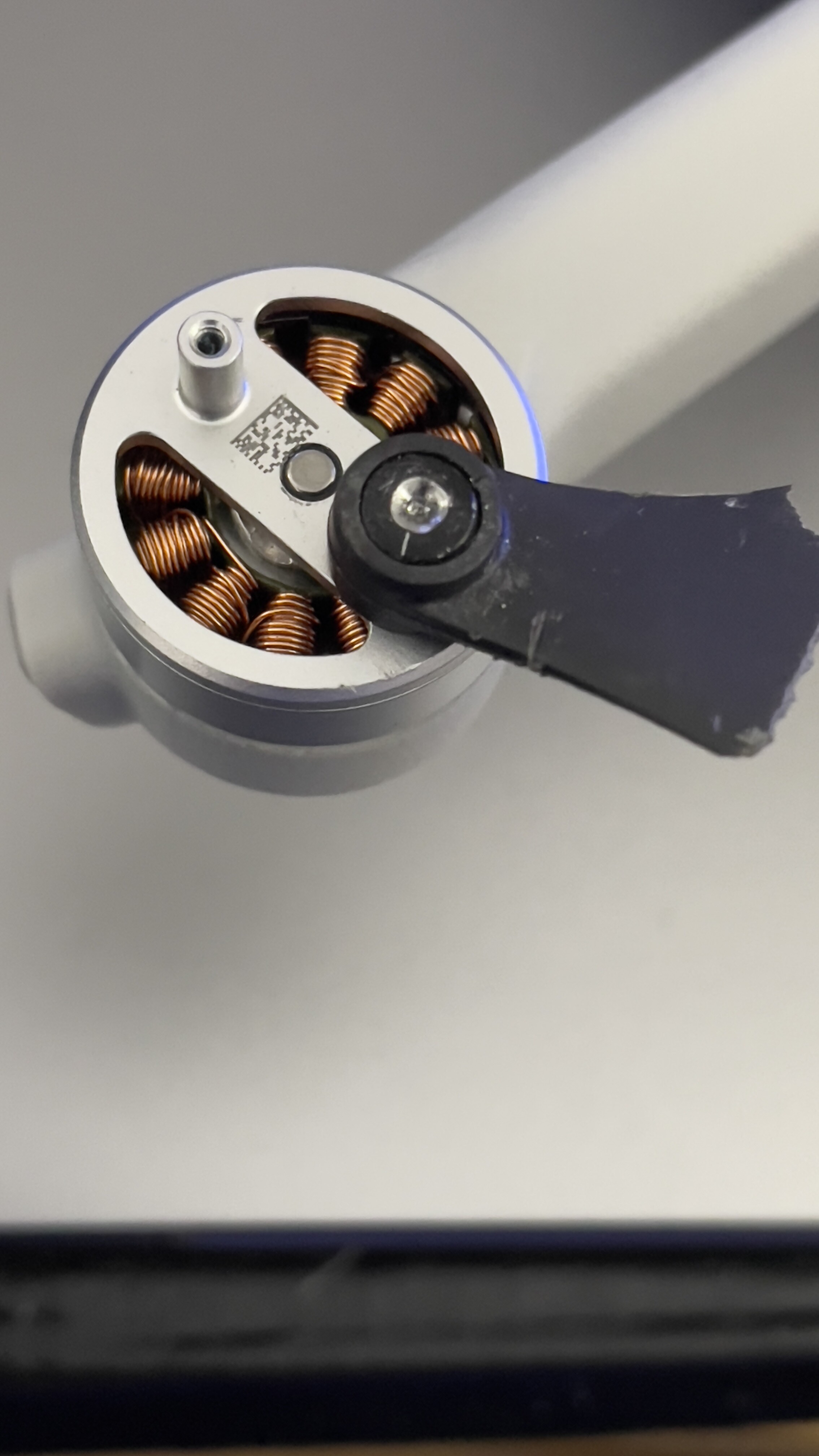

Have to replace my propellers, for the life of me I can’t get this screw out and it’s now threaded. Any ideas anyone? Tried gaffer tape etc… :weary:
Pliers or vice grips see if can get a grip of it
You could even try to cut away the plastic of the prop
If you have a dremmel or equivalent, maybe, just maybe, cut a slot straight across and try with a flat point screwdriver
Just to note, I haven’t used this site I just googles easyout and this was the first result.
I’d go this way
Cut away the prop then pliers gently on the body of the screw
Gonna give it a try thanks
Like this
@stegib
If you are struggling let me know, I am not too far from you
Yeah I’m struggling, I just realised I don’t have any pliers! :joy:
I used my wife’s very sharp nail clippers cutting the plastic away and then I unscrewed the head easy with pliers.

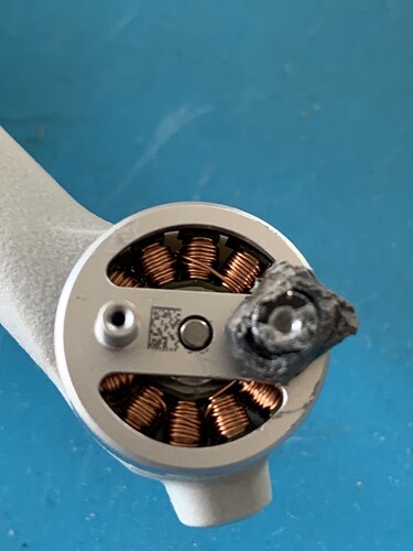

Well, the genius who is @SparkyFPV Completely got the screw out and helped me put on brand-new propellers! I will be eternally grateful thank you again so much Wayne!
Happier flying to come! :smile::+1:t2::smile::raised_hands:
No worries Stephen, glad it came out and your back flying again
The offending article :grinning: :point_down:
dont forget to blow out the motor, as fragments of metal and plastic in the windings area
Jesus Wayne did you chew it off

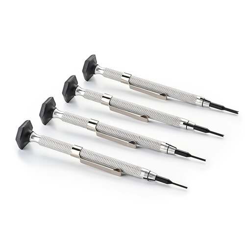

Check out this iFixit page - it’s a useful disassembly guide and they sell really good tools also. DJI Mini 3 Pro Repair - iFixit
