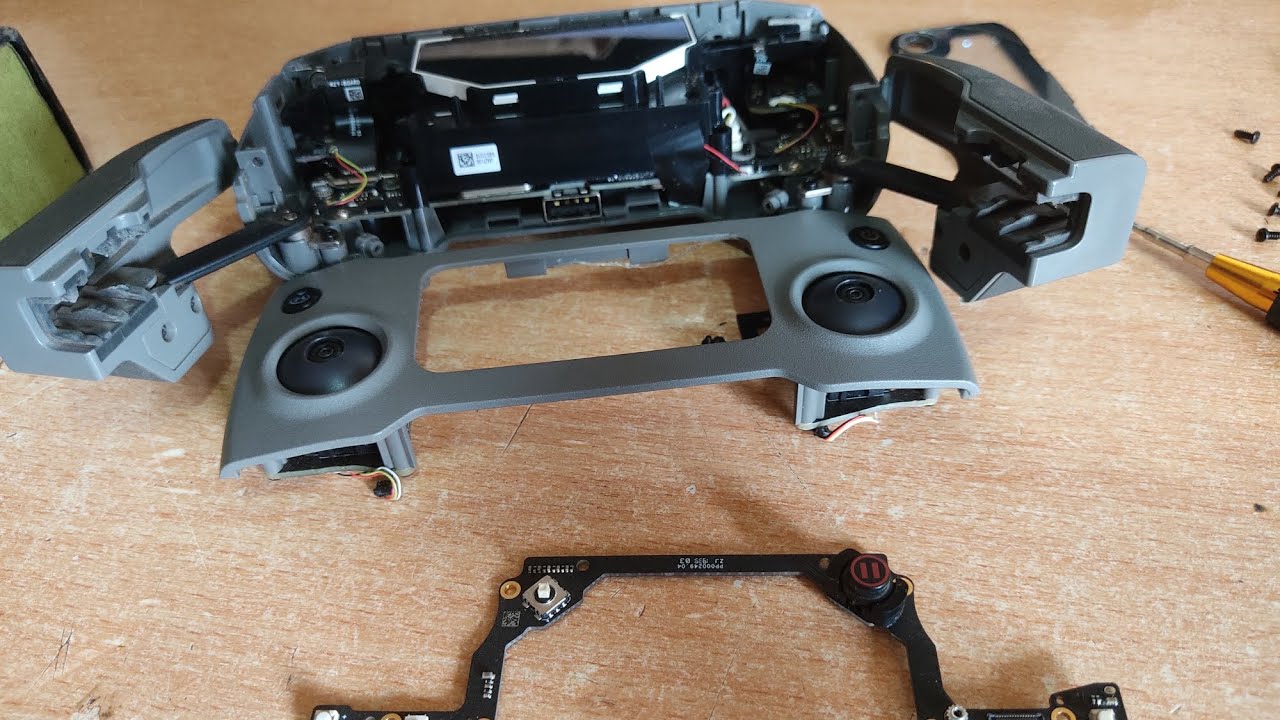

Have a look at this short video it seems like it just pulls out so I’m guessing it’s just the reverse clipping it back into place,
Unless as mentioned above if maybe something is worn,
Hi thanks for the link. Not sure I really want to do that!!! Let show what they said via email…

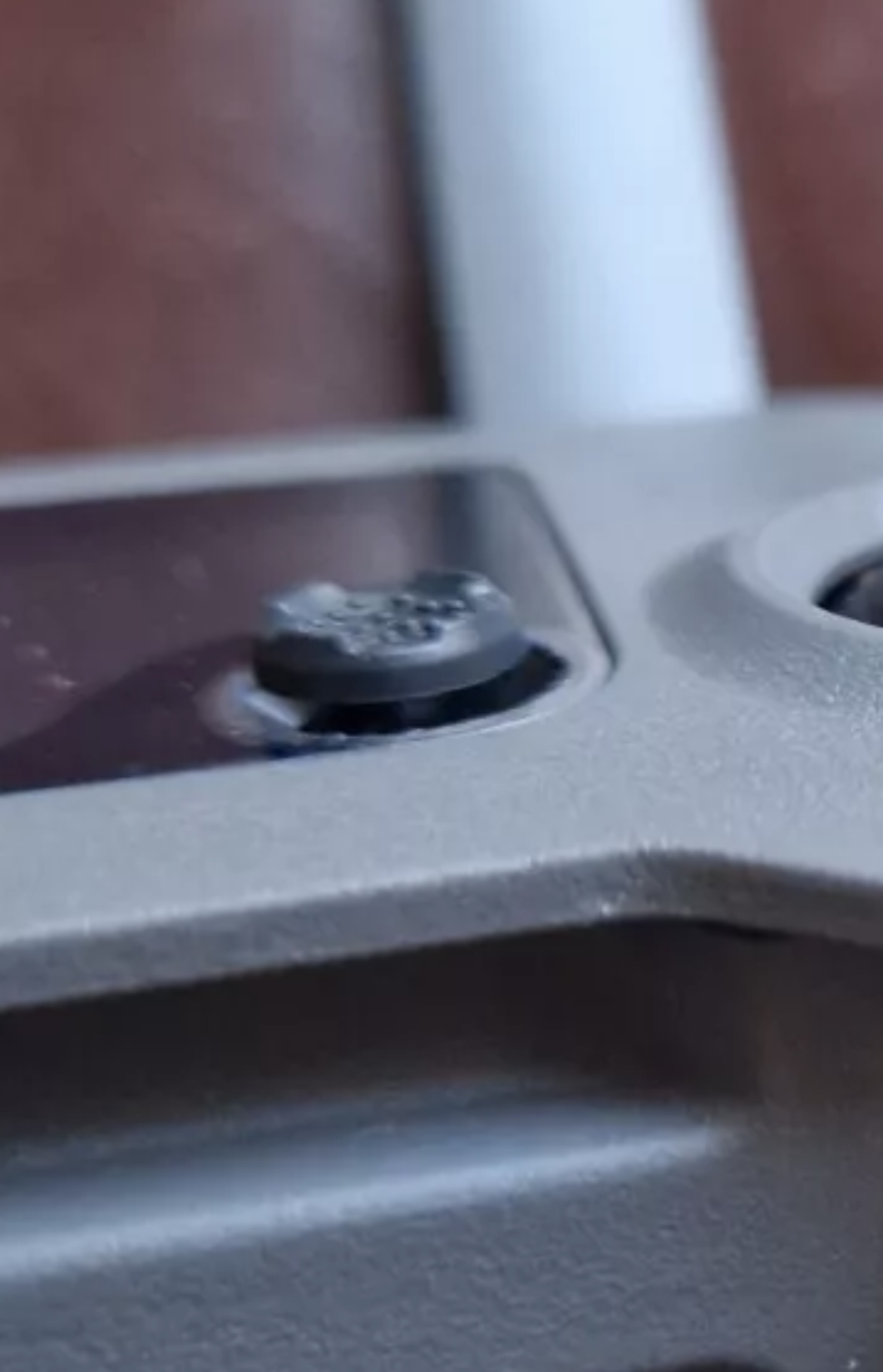

I know there saying it sits flush but of all the DJI controllers I’ve seen with the 5D button ( even my rc pro ) they all sit slightly proud so they have the movement of side to side / up / down bottom if that makes sense,
Post a picture of how yours is if you can :+1:

Wasn’t saying take it apart, it was the only video I could find showing what seems to be an easy snap out & hopefully snap back in process.

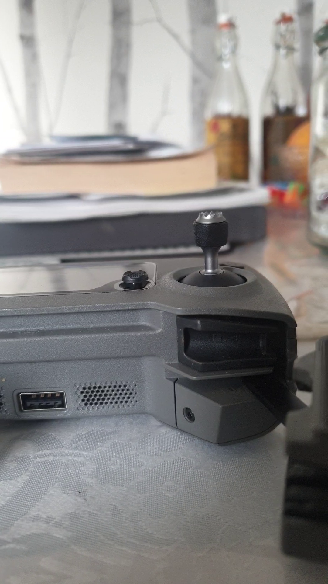

My Mavic 2 Zoom controller (same as yours) has a 5d button that doesn’t sit flush, and never has.
Picture as requested.
Looks right to me, as long as it’s clipped into place & not falling out & functions I’d say it’s all good to go,
I have since been looking at the same ( but others ) they all seem to be the same & is what I thought, picture below of another one ( again they sit proud )
Then this makes me a hapoy chappie. Thank you. You have helped heaps. Thougjt I was gonna have to spend a ridiculous amount of money for nowt. Lol. If ya around Burton next week I will buy you a pint or 3!
