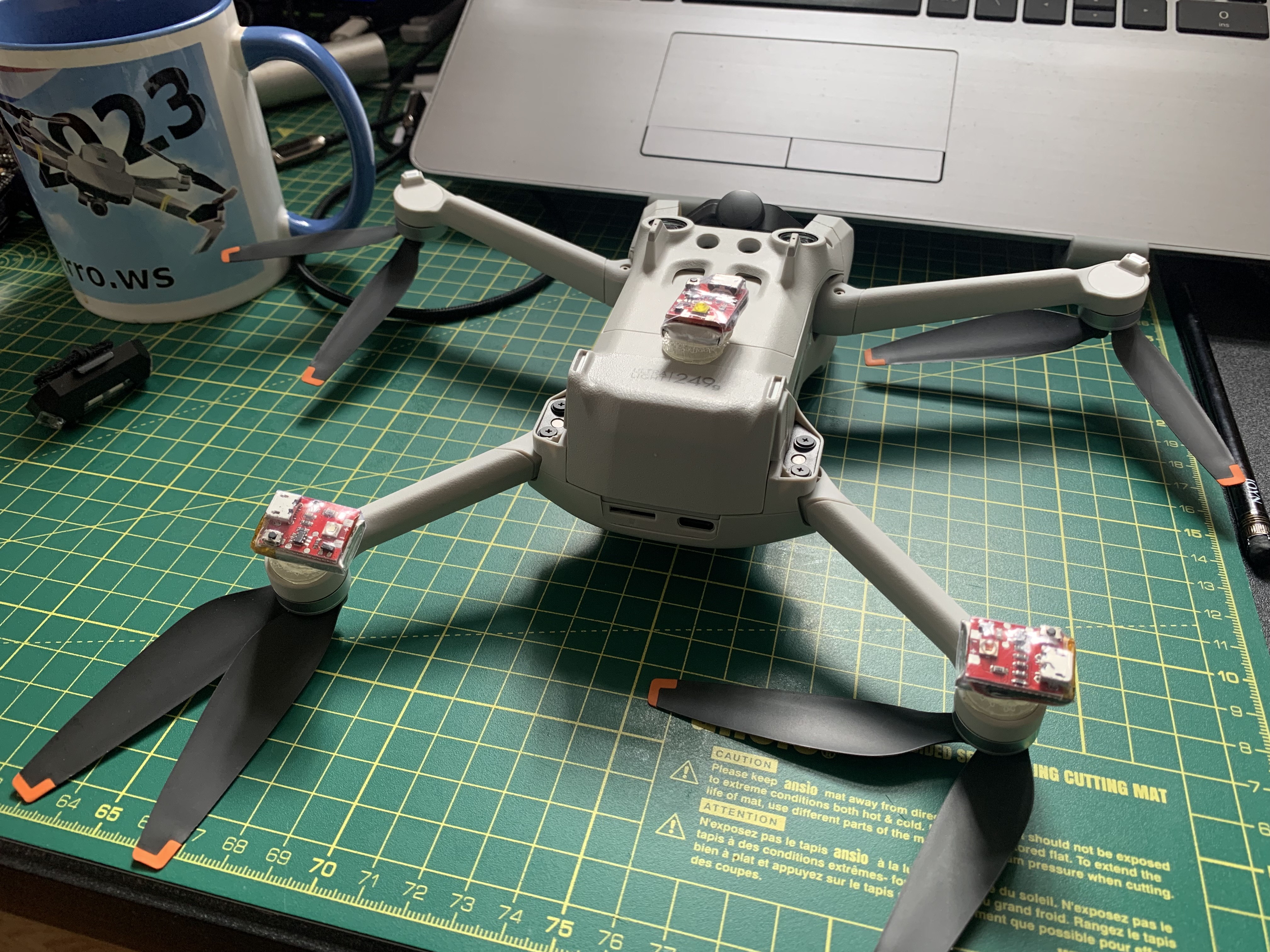

Yes that what I use with the Cree Strobons

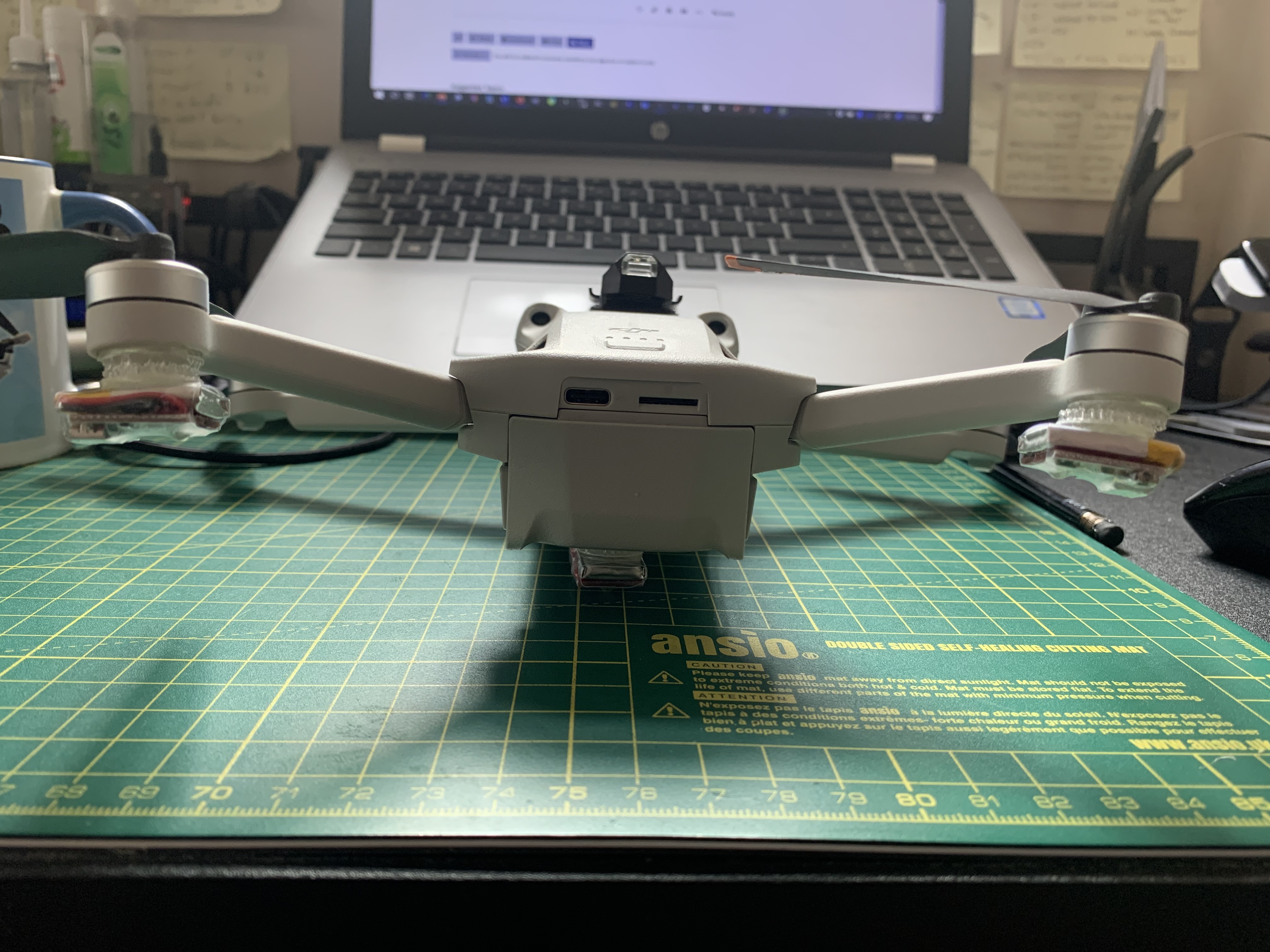

With the one underneath you have to hand launch
You’re very unlikely to keep the weight on the mini 3 below 250 g with a strobe.
As for mounting, I (and many other people) use 3M Dual Lock (which is not actually Velcro sorry @SparkyFPV). You’ll get it included with a lot of the strobes.
Dual lock is more rigid when fastened, and has some tactile feedback confirming it’s attached. Where even strong Velcro has a bit more play, and the industrial stuff is actually a bit too grippy in big strips.

As @SparkyFPV shows above, loads of fixing points.
Yes I was referring to his comment and the fitment :wink:
This is true but it doesn’t stop you from flying in the correct class

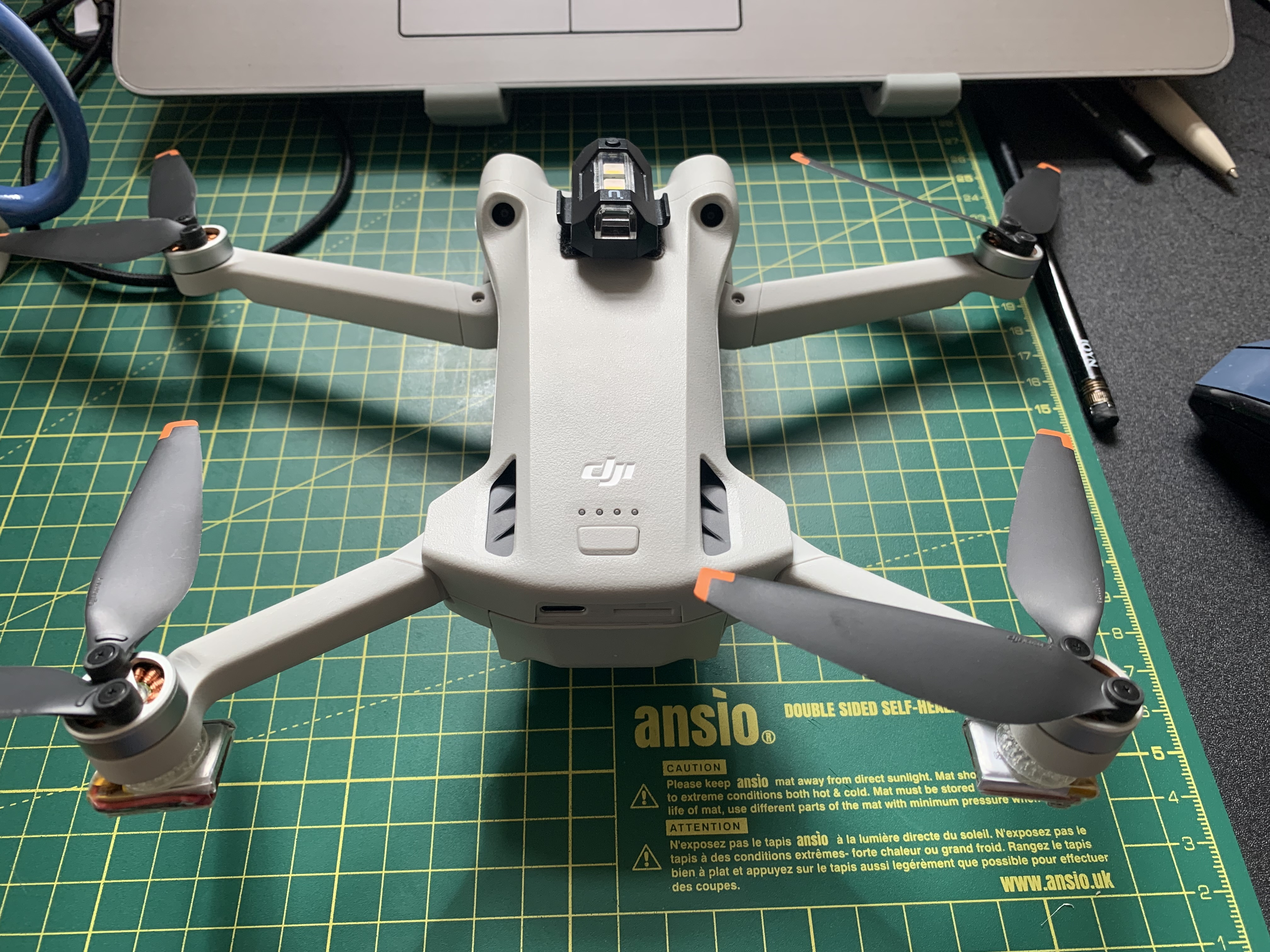

That’s terrific. Thanks. Didn’t have the landing issue with the SE/Mini 2. If weight is not a consideration, I may use your approach of mounting under the props. That looks good, though I would have to buy a second light.
PS. I think the Vifly looks a lot more shallow than your Strobons, so it may well land OK.
Ha ha. I was under the illusion that I had kept the SE/Mini 2 within weight. Probably lighter in the first place than the 3 pro, with all its sensors.
But yes, I can still fly in A1, albeit with a little more caution when people are around. I tend to be cautious anyway. I will weigh everything up, and if the total is over 250 with the one light, I will add a second strobe and mount both below the rotors as in the pictures above.
