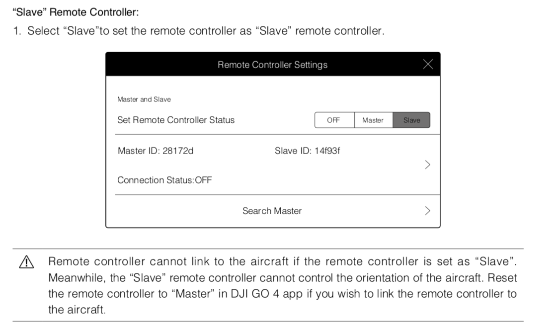

not finding anything on the inter-web
![44|690x275]
This one worries me
let me edit the fucking thing dave
Cheers Jeff @sparkman999
Appreciate you taking the time to reply and you don’t even have an Inspire 2.
I’ve put the RC on charge again, it it is showing 75% charge.
This looks like it may be the issue, not sure how to check what the fault is.

All sorted, was inconsistent firmware and then need to recalibrate sticks. Appreciate you taking the time to respond.
