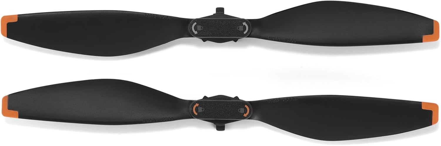

Had a quick look on Amazon and these are authentic DJI props (DJI Store)…
Thank you. I just had a look. Thank you kindly. :sign_of_the_horns::sign_of_the_horns:
Do you have the DJI Store app? Props are on there for £9 (presumably the same as the Amazon ones listed above). Looks like shipping is free too.

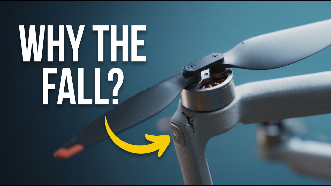

Is this the video ?
That is the video I’ve been talking about. It shows you how strong these props are. You didn’t hold back, did he. The only thing I can think of is that they crashed it or they hit a branch in flight. If there is a fault. DGI are keeping it to themselves but that’s another story

Here’s another video for you @Minty1 …
Suggests the same issue as the video above :+1:
