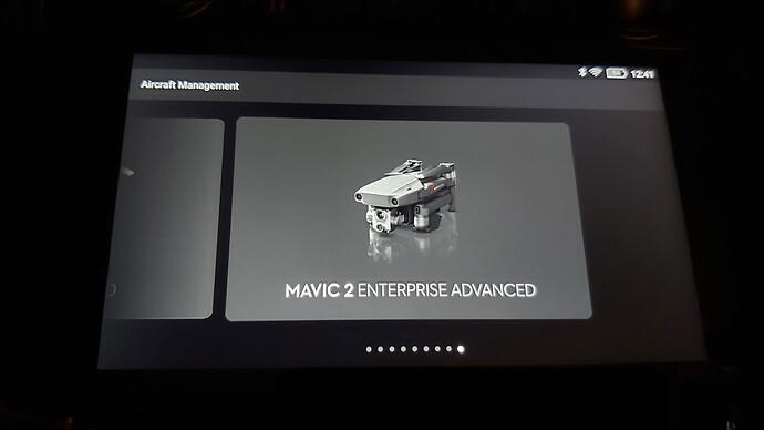

Well i got one… but
:thinking: ?
Working out what to pair… beep beep beep lol
I know Jack about the mavic 2’s but was just looking on Google at the differences ….
Hmm will it pair :thinking:
So it says.
Not too sure if it will work with a screen controller
