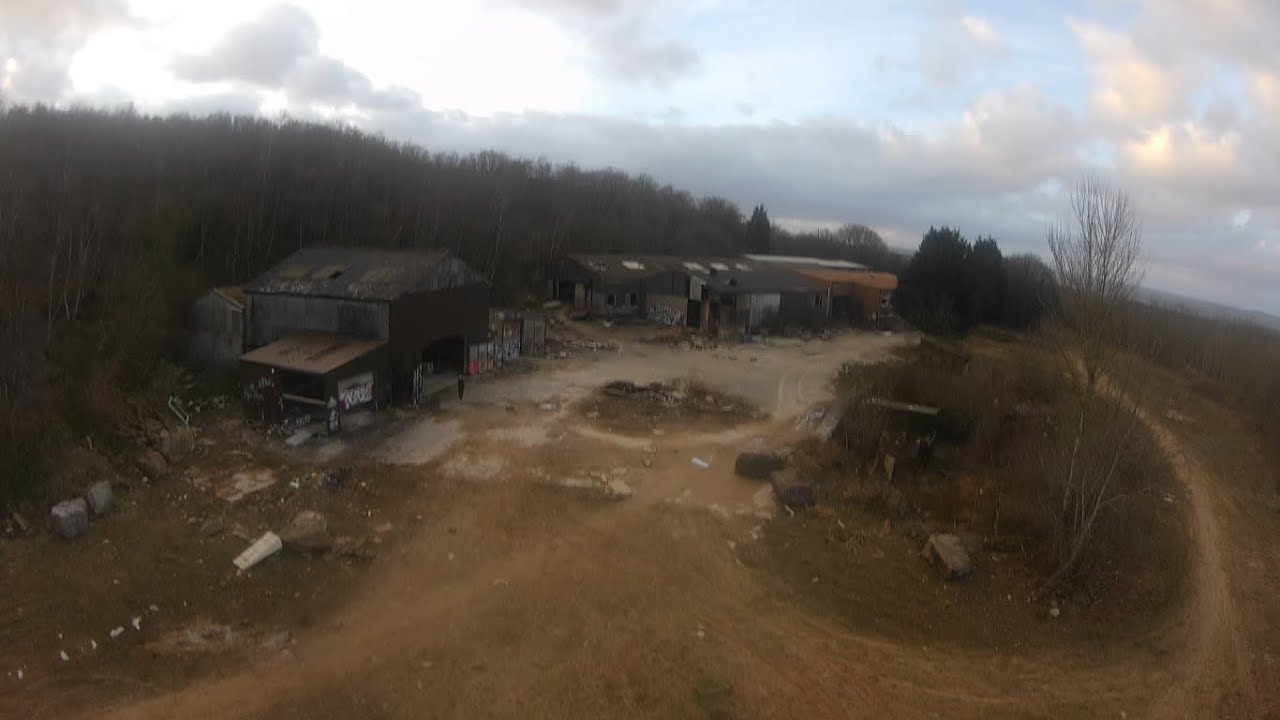

So this is the video from one of my flights with my home built 5" at the weekend.
You’ll notice there is an almost constant “jittering” low frequency vibration in the image. Not Jello. In fact I don’t think there is any Jello to speak of.
I’d like to clean this jittering out… I’m assuming it’s something to do with the flight characteristics… Is this something that adjusting PID tuning can fix?

Which camera was this filmed with, and did you see the same issues in the FPV feed?
Runcam Hybrid 4K. and yes… though it’s less noticeable in analog.
I did also see it in the latest videos with my Gecko, which has a Foxeer Mix on it. This only after upgrading Betaflight and losing the custom tune the previous owner had on it. It was smooth as silk before then.
That rules out my initial thoughts that it might have been an unwanted artefact of image stabilisation. I see a similar effect if I use IS on my Runcam5 HD camera.
More head and chin scratching required :thinking:
