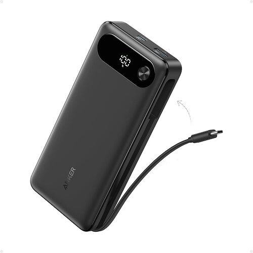

I seem to be getting fast charging from this powerbank but it appears to only charge my DJI Flip batteries in the charging hub individually. On mains, the hub can charge two at a time.
Based on the the image below, is there any likely speed benefit in using multiple ports on the power bank at once and charging multiple batteries without the hub, one per cable?

I believe the output wattage is insufficient, needs something in the order of 60w. I use an Anker power bank 140w.
And chargers all my batteries quickly.p, without issue.
