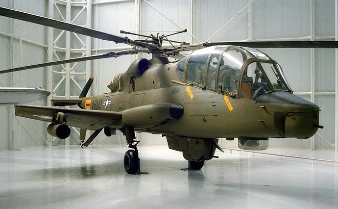

Has anyone fitted stub wings to a drone to take some of the load in forward flight, and maybe increase battery life ? I know it’s been tried on various helicopters :slight_smile:

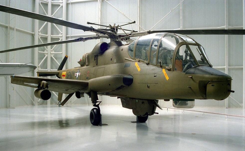

I don’t think the wings on an Apache are there to provide lift but rather to hold the armament. They are wing shaped for stability to help combat the drag a full payload would create.
The pic above isn’t an Apache :wink:
It’s an AH-56 Cheyenne, and the wings definitely did provide lift :slight_smile:
Another example would be the S-67 Blackhawk, which went as far as having control surfaces on its wings - seen below with them deployed as airbrakes.
images
My mistake. I broke my own rule by making unfounded assumptions.
I have acquainted myself with the facts about this aircraft only to find out it has a very interesting, albeit brief, history. Quite surprisingly is how effective the wings were in this compound design, meaning when the pusher prop was in use the main rotor only accounted for 20% of the overall lift.

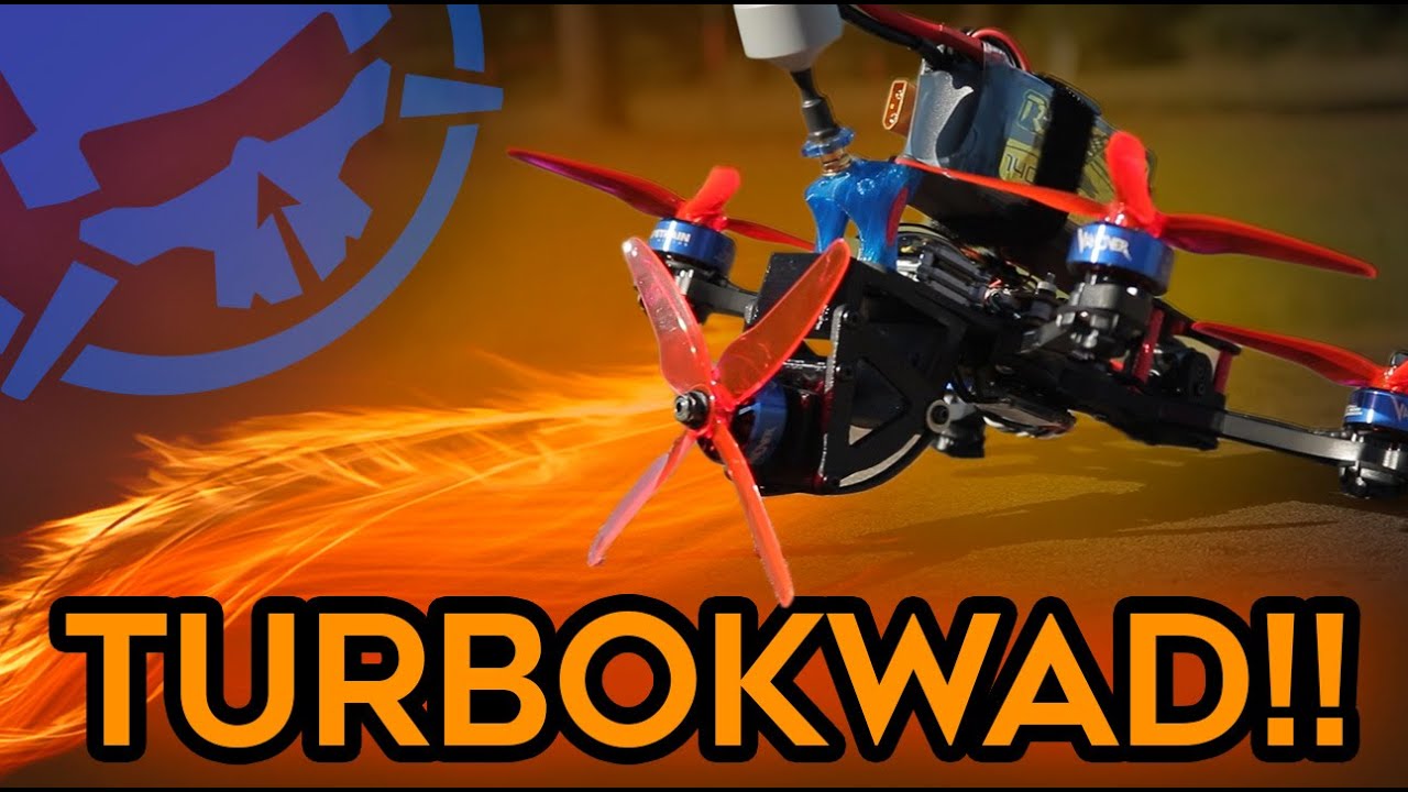

IRotor Riot made a video of a pusher prop fitted to a race quad with some very surprising results.
Crazy speeds ! :rofl:
