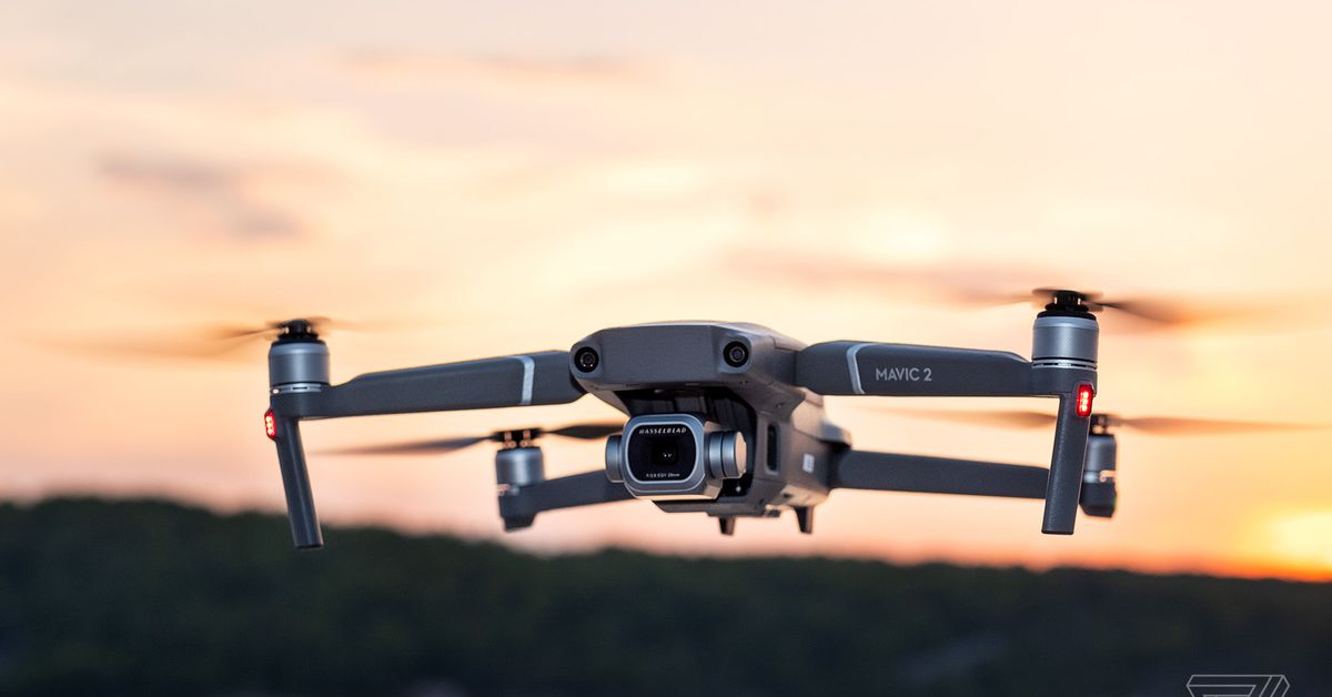

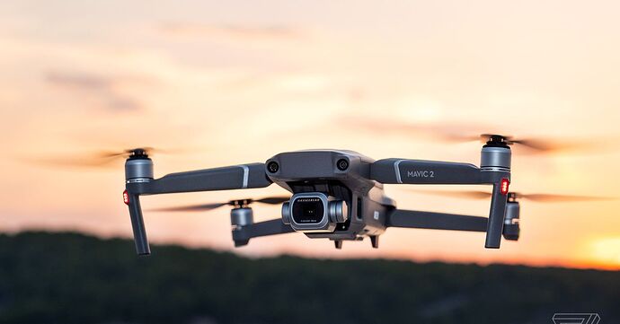

It has occured to me that the technology of drones is quite well advanced.
Bearing this in mind, what is everyone’s opinion on this…
A drone (such as a DJI. Not a racing / freestyle one) that had the ability to monitor it’s surroundings with respect to manned aircraft. And give warnings and/or perform a safe low level hover procedure until the target has passed for example.
I am just spit balling, but I feel this LOS rule is getting outdated. It can be restrictive to us.
If you feel I am wrong, to be constructive, how would you propose a way forward to have a way to be exempt from LOS (without a spotter)?
