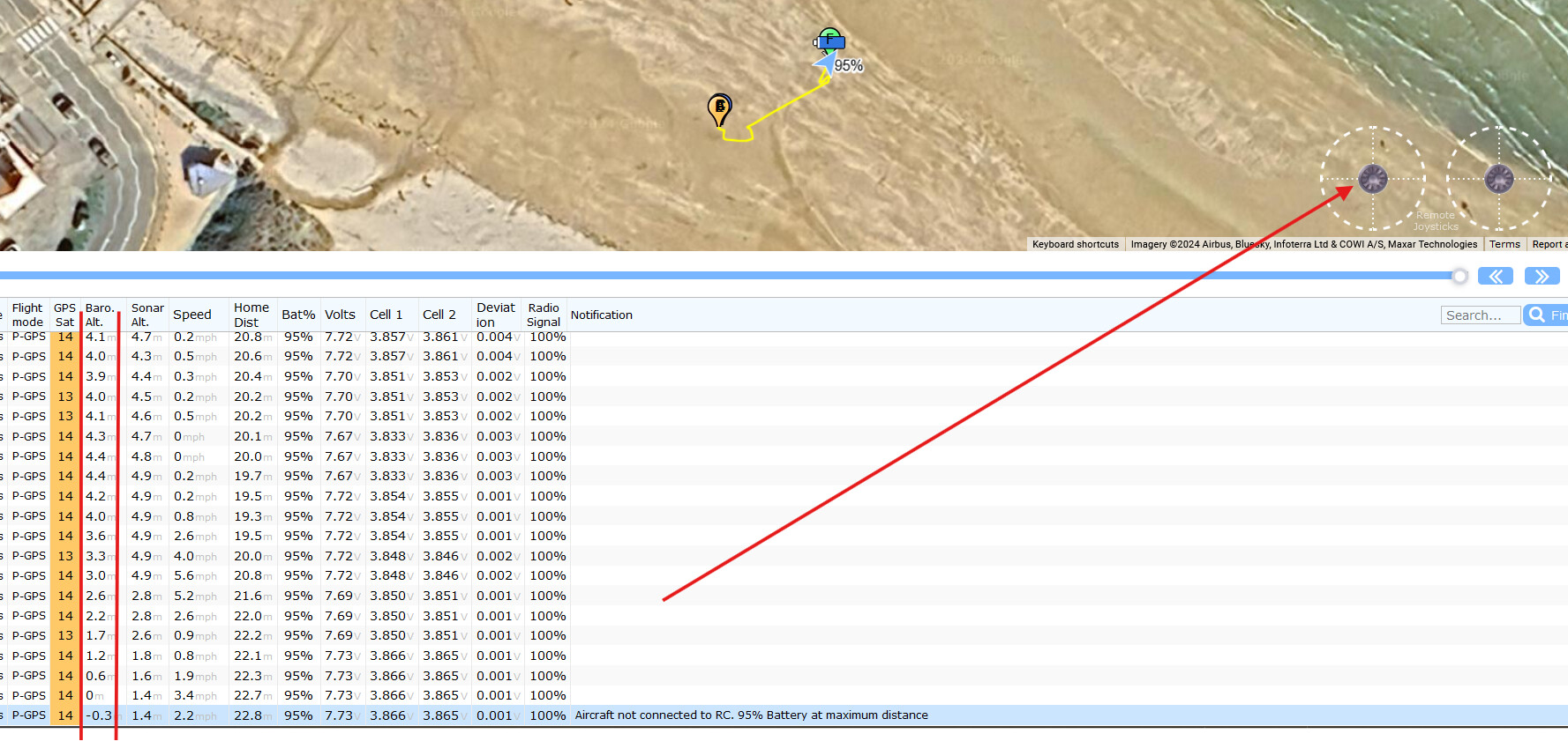

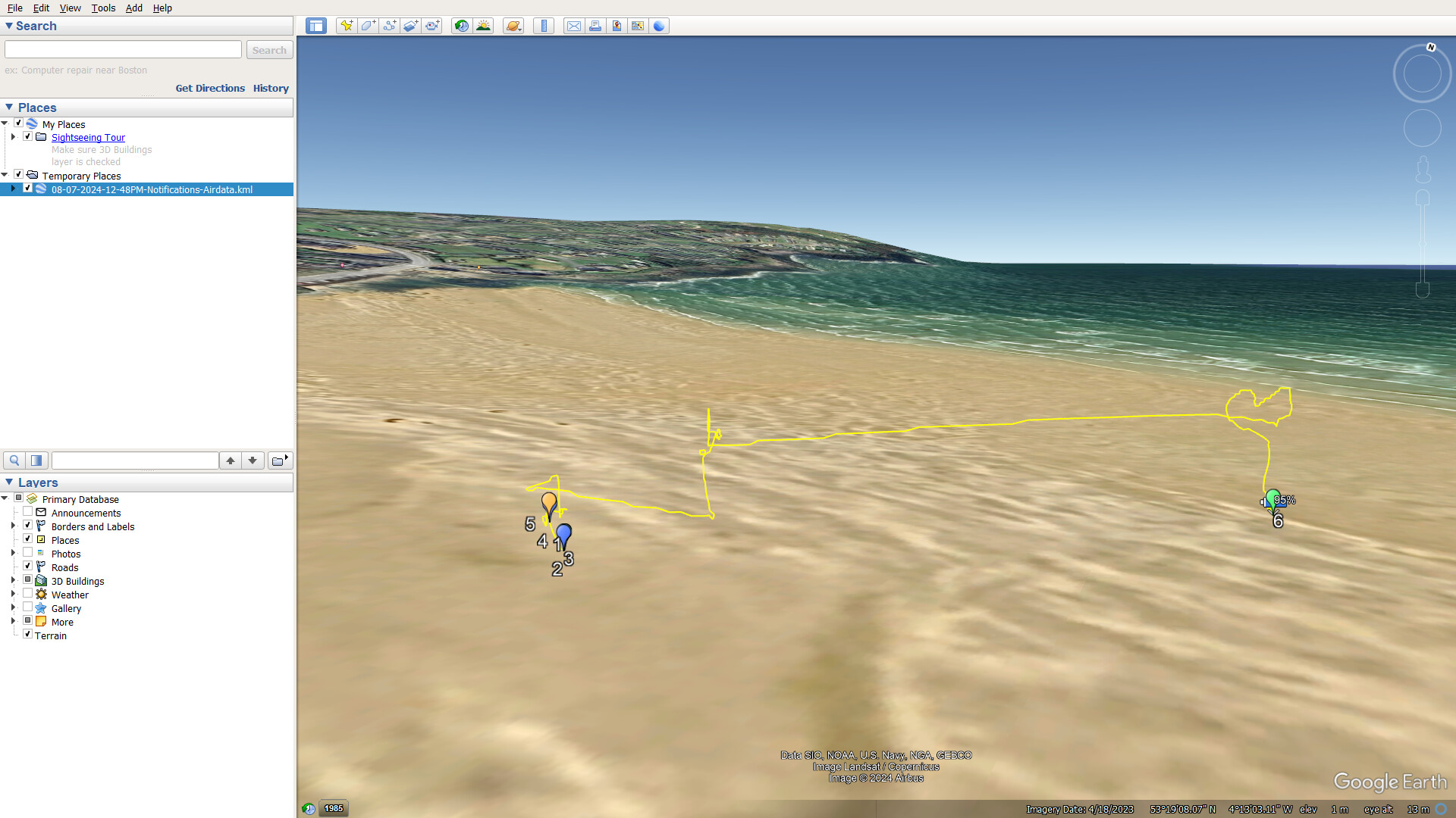

@milkmanchris here’s the flight data. Pilot error??
Blimey you’d only been in the air for 56 seconds and your battery was at a max temp 78.8f :flushed:
That’s not much …just 26℃ … not much warmer than a warm day.
You were not very high and the bottom sensors would have been confused by the water
But you didn’t push the left stick up and you let it in land in the water
Yeah I saw that. I thought I did but obviously not. Think I just panaked when it started coming down.
I suspected it would be pilot error.
Upgrade :wink:
Good excuse for on eh. :wink:
