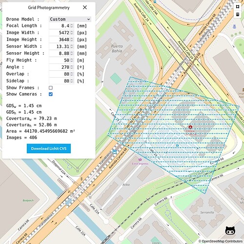

Hi, I came across a tool via the litchi forum for planning grid waypoint mission planning which seems to have proved to be a great tool especially if you intend to do mapping missions or photogrammetry missions.
The only problem was that the tool was not really developed for a couple of years so the cameras that were listed were a bit older or rather for older drones.

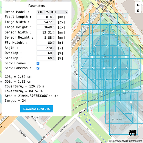

All I’ve done is forked the original github and deployed it as a webpage. The only camera I’ve added at present is the Mini 3 Pro (with details off another forked repository).
I would like to add the Mavic 3 range as well as a few more cameras. feel free to post some camera info and I’ll add more too.
the info that I need is:
name: 'AIR 2S DJI',
focalLength: 8.4,
imageWidth: 5472,
imageHeight: 3648,
sensorWidth: 13.31,
sensorHeight: 8.88
