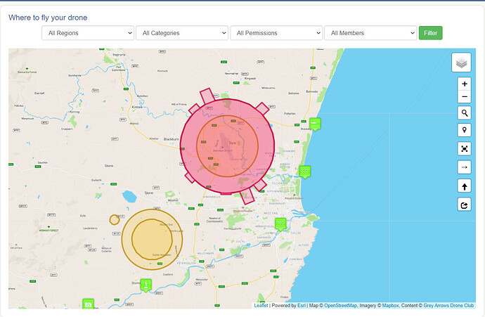

Hi everyone. I just bought a DJI mini 2 and am brand new to this! I’m still trying to understand all of the restrictions on mapping apps. Could anyone help me understand what restrictions are in place on this picture. I hope it uploads ok!
It’s an area around Aberdeen, shaded in blue, says EGPH. The app won’t tell me if this area is forbidden or what restrictions there are. I’d be grateful for any advice. Thanks.
It’s called Class D airspace, you can fly in this airspace just be cautious. Obviously the boundaries around Dyce airport is a no no. I’m in Ellon by the way. Welcome to the club as they say. I’m sure you will enjoy flying your drone.

For places to fly and to check restrictions I’d suggest using our very own Drone Scene - Where can I fly my drone in the UK? - Drone Scene The red area is the Flight Restriction Zone for Aberdeen airport. You can fly in class D airspace as you are flying under 120M.

As previously mentioned this is termed as Class D airspace. As a drone user this has next to no impact on yourself other than to be aware that there will be General Aviation (GA) activity in this area.
As you have a Mini 2 you will unfortunately be plagued with the DJI App continually pestering you with a pop-up that you will have to acknowledge before continuing with your flight. This has ABOSOLUTEY NO LAWFUL implication, and is just DJI being a pain in the rear end.
Below is my area as depicted in Dronescene (bookmark this page from the link found on this site, it’s worth its weight in gold, if it actually weighed anything.).
The large light red area is Class D airspace associated with Leeds and Bradford Intl airport. Also within this area are three very popular model flying sites, including the club of which I’m a member of. I am free to fly anywhere within this area subject to the regulations and guidelines stipulated by the “Drone Code” and those of the CAA regarding the use of personal SUAV’s.
Finally, do not rely on DJI’s interpretation of NFZ’s and restricted airspace. Use it as the flimsiest of guidelines as in many cases it is incompetently inaccurate.
